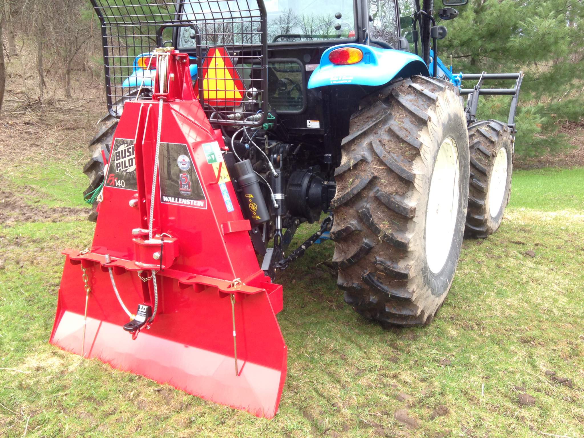

+3 on the steel cable. The only caveat would be if you didn't have the physical strength to handle the weight of the steel cable. I have the FX140 and pulling/wrestling the cable all day long can get a little tiring, but for most people in good physical condition it's fine.
I struggled with the remote question myself and could see where it might come in handy in a few situations but not at the price they were asking. Standing next to the tractor and operating the winch gives you a a good idea what is happening to the tractor and log you are winching. I just make sure I have cleared up anything that might get a log hung up prior to winching.
Good luck and be safe!
