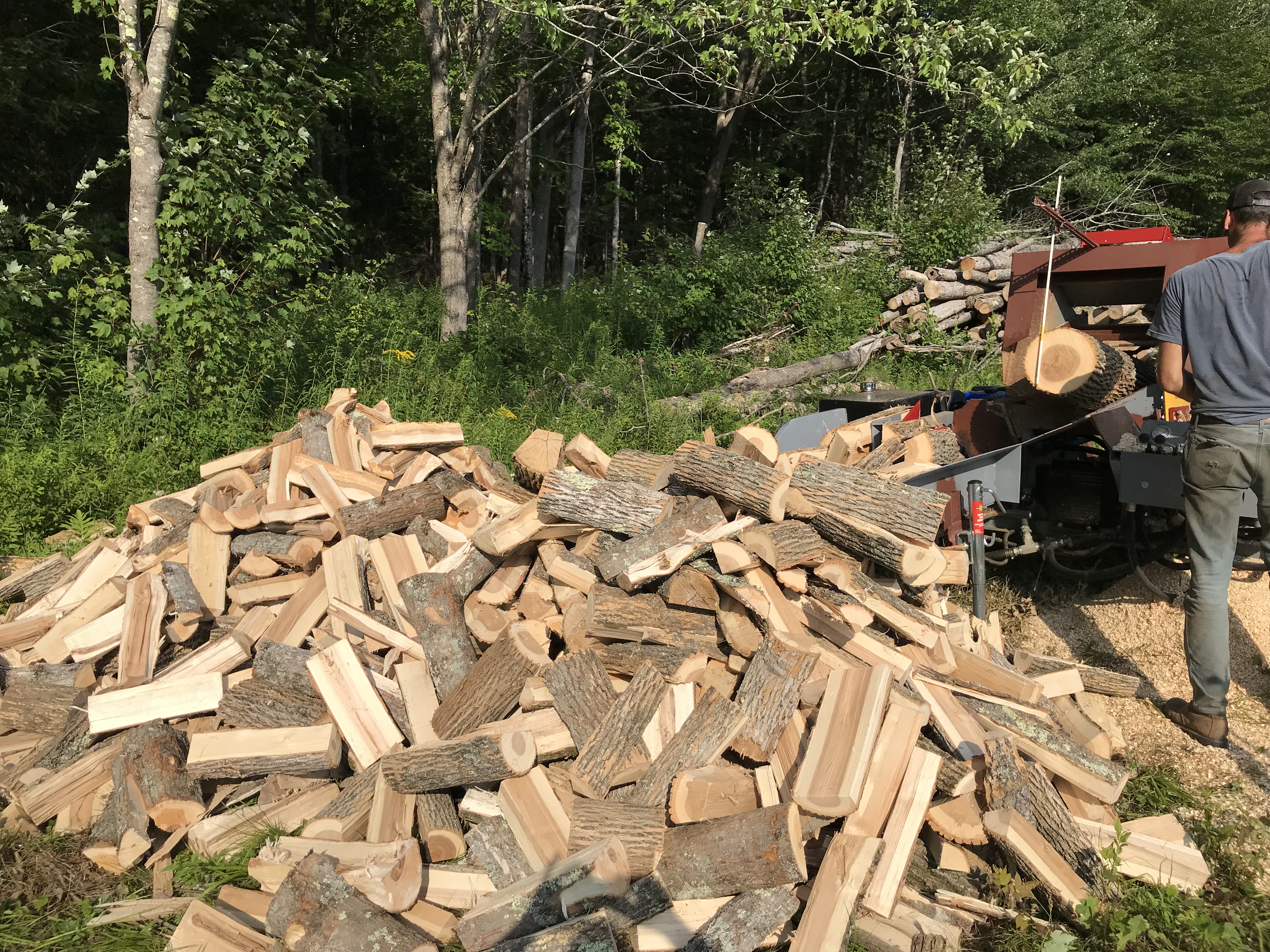

a) The splitter is now powered by a 18hp duromax, (the 16hp was also adequate)
b) The saw is powered by the HF 22hp motor, as the 18hp was stalling at 1500psi. The 22hp does not stall, it can push up to about 1900, where the chain slows down. We filed the rakers a little bit which improved the cutting speed. Its needs a little more experimentation. I think thats about the speed limit with that type of cheap gear motor before having to jump to a lot more expensive (bent axis maybe??)
Looks like a lot of sassafras.
White Ash :) With some sugar and red maple. Its too cold here for sassafras :)
