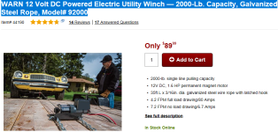

I am also looking for a solution. I have the same type tilt trailer. Not a pitch, but this may be a solution. Northern Tool sells a winch that is attached to chains that allow the winch to sit further back on the trailer. There are pictures on the Northern Tool website. The winch is the "WARN 12 Volt DC Powered Electric Utility Winch 2000-Lb. Capacity, Galvanized Steel Rope, Model# 92000". I'm not sure the picture will show up, but you can google the product and see the second and third images with the guy winching up his car on the trailer.
