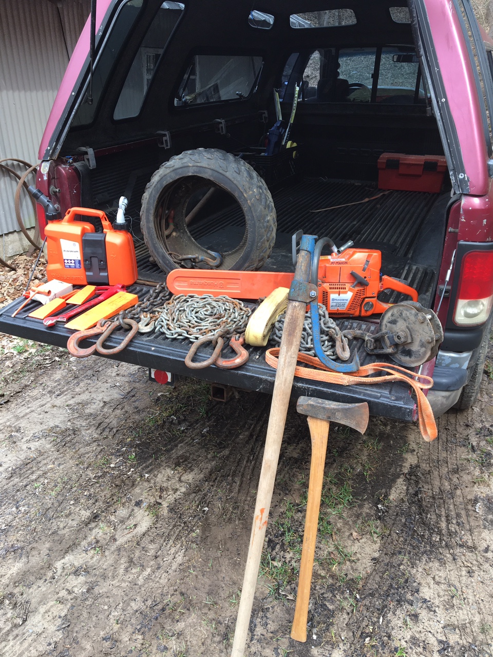

Hard to beat 120’ cable, some chains, strap, snatch block, rigging shackles and hooks and a tractor for occasional logging. Save a lot of money by doing a little walking.
