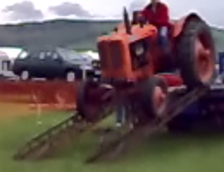

Those ramps look to be longer than 10' to me and very heavy.
Chris
That tractor rolling down the ramps in the YouTube video looks like a Nuffield Universal Three or it's successor the Nuffield 342. The wheel base on these tractors is about 80 inches.
I snipped the video at the point where the rear wheels of the Nuffield just roll onto the ramps.
It looks to me like the front wheels are more than halfway down the ramps. My estimate is they're 10-11 ft long.

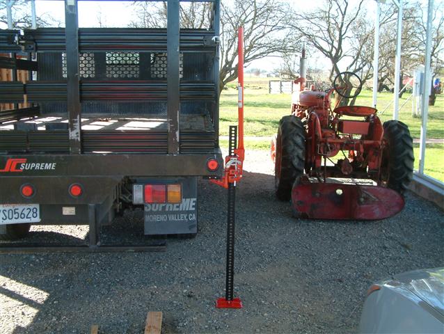

   / Winch installed on the Isuzu NPR #12
You're right---the roller part of that setup needs to be wider--another trip to the hardware store.
I've attached brackets to the underside of the stakebed rear end for a pair of farm jacks to keep the front end from lifting.
No plans for trailer towing--haven't installed a receiver hitch yet. I don't have any info on the NPR towing capacity but I suspect it's not that large-- maybe 6000-7000 lb.
