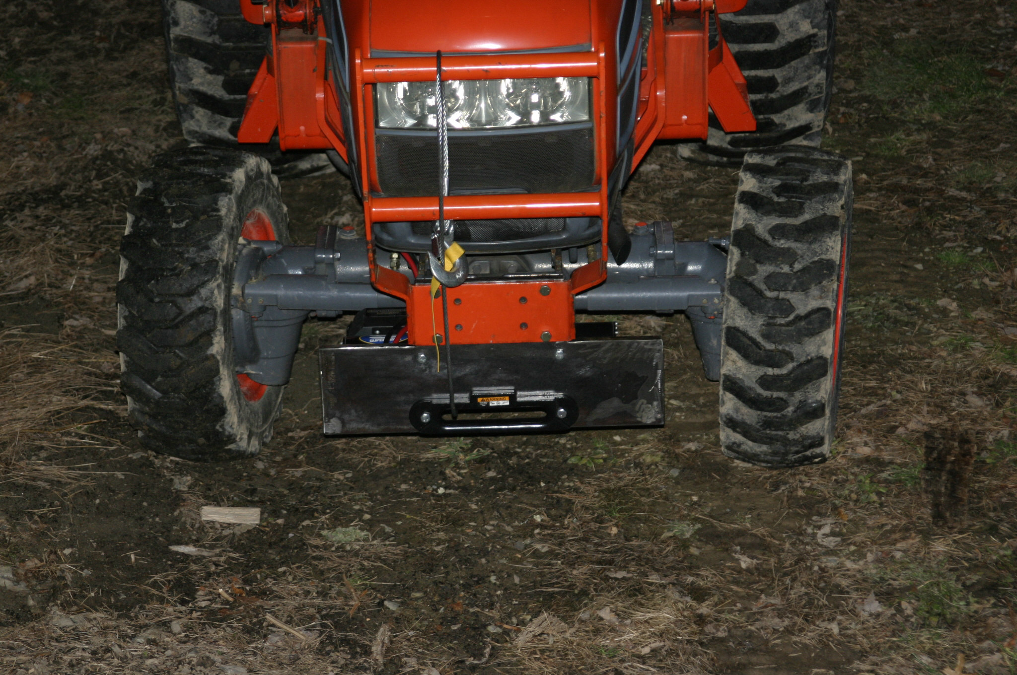

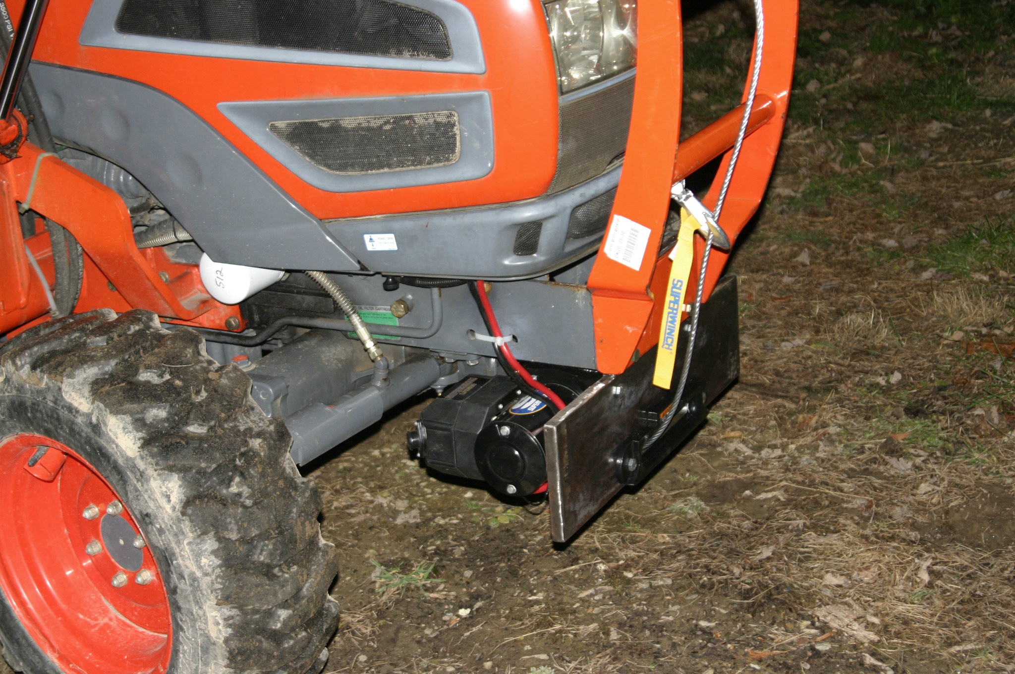

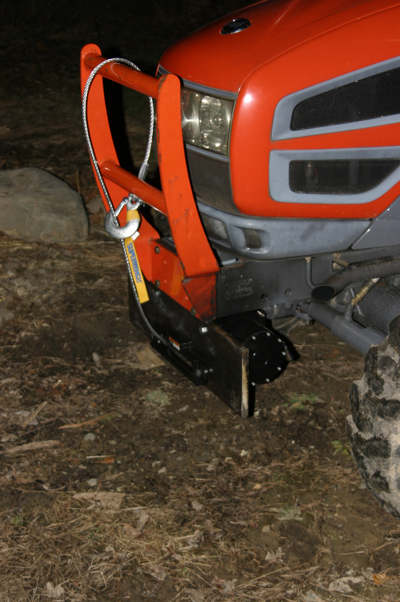

I mounted up this Superwinch 8500 to help me drop some trees not on my shop.
If I can get about 6 down, with no 'collateral damage', it won't owe me nuthin. :D
   / Winch #2
How does your alt and battery do with it? I have a Warn X8000 I have thought about mounting, but not sure how the electrical would hold up to it on hard pulls.
   / Winch
I just got it installed tonight. The specs recommend a minimum of a 60 a. alternator, the Kioti has a 50 a., but I don't intend to use it anywhere near it's full potential, only need to get some trees leaning the right way.

I have dropped a lot of trees, and I've been on the pulling end many times, too. I would be reluctant to use a winch, because they operate so slow. You can get tension on the tree, but once it starts to move, the object pulling has to move too, and keep the tree falling where you want it. Sometimes, the tree will go where you have directed it; sometimes, it needs continual direction. A winch can't deliver that. I'm not saying don't use what you have, and I may be wrong in how I think and approach the job. But, I would, if it were me, not rely soley on th winch. I would pull the line taunt, and once the tree starts to move, move the tractor back instead of reeling in the winch. The tractor will move fast enough to keep up with the fall of the tree.
   / Winch
My plan is to prop the bucket against another tree, and winch to a pulley on a third tree that's in the direction I want it to go. I don't care too much where they go, just where they don't go. Nothing's leaning too drastic, should only have to winch hard for a few feet.

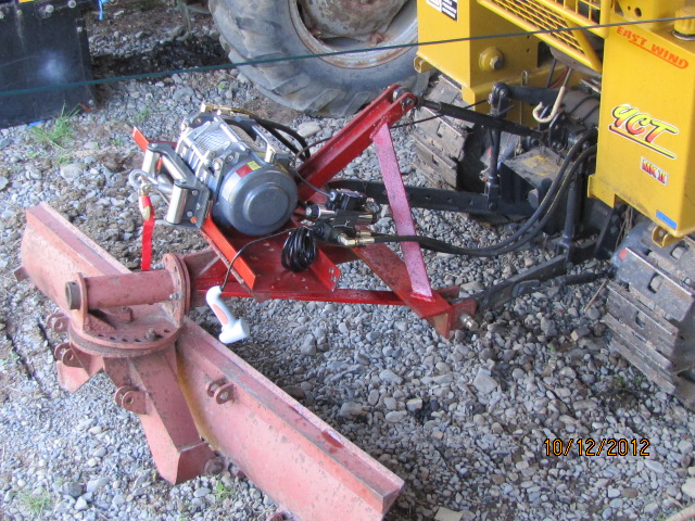

I have just put a winch on my little Dozer I went for a Hydraulic one to avoid any hassles with the battery I mounted it on a three point hitch grader blade I can reverse the blade to give me extra anchorage I anyone gets stuck driving across the river to visit me I now have the tool to pull them out.

That's a nice looking winch, got any details on it?
   / Winch #19
The winch is a Runva HWN 15000YD Hydraulic Winch
A 15000 pound rated pull but in real life has only about 10000 pound pull once it has three layers of rope on the drum I have a pulley block to use with it which will double the pull but that will depend on how well the grader blade digs in as I have found out with the winch on my Landcruiser a winch is only as good as its anchor

Runva electric winches look a lot like a Superwinch, maybe they're made in the same place. After using mine for a couple hours, the idea that it would be a temporary installation is out the window. I think I'll order another snatch block so I can use two, one up high on the tree dragging end, and another down low, so I don't lift the tractor. Besides, using one looks too much like a sling-shot aimed at my head. I have to skid pan it too, to protect the wires on the bottom. I would have mounted it the other way, but that would have put the cable slot on top of the mount and weakened it. (probably could have wound the cable the opposite way on the drum, and run it backward, now that I think of it.. 20:20 hindsight) anybody know if the winch cares?
