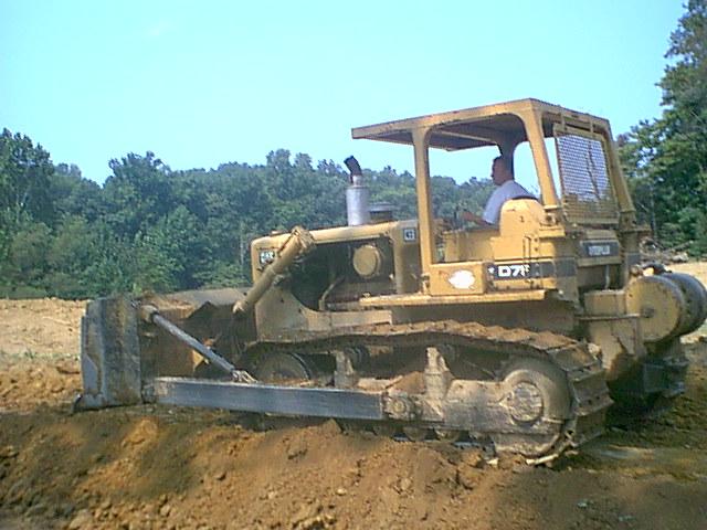

I'm guessing it was somthing like the winch on the rear of this dozer. Winches of this size have the power to pull your car in half and certainly the power to destroy arms and legs.

OK, thanks for clearing that up. Now I understand that "the drum of a piece of equipment" was the winch drum itself. I had it in my mind that the winch was pulling some other piece of equipment or something. It's still amazing that it killed him instead of ripping off his hand or arm first. I'll definately watch out for any loose wire on the winch cable!
