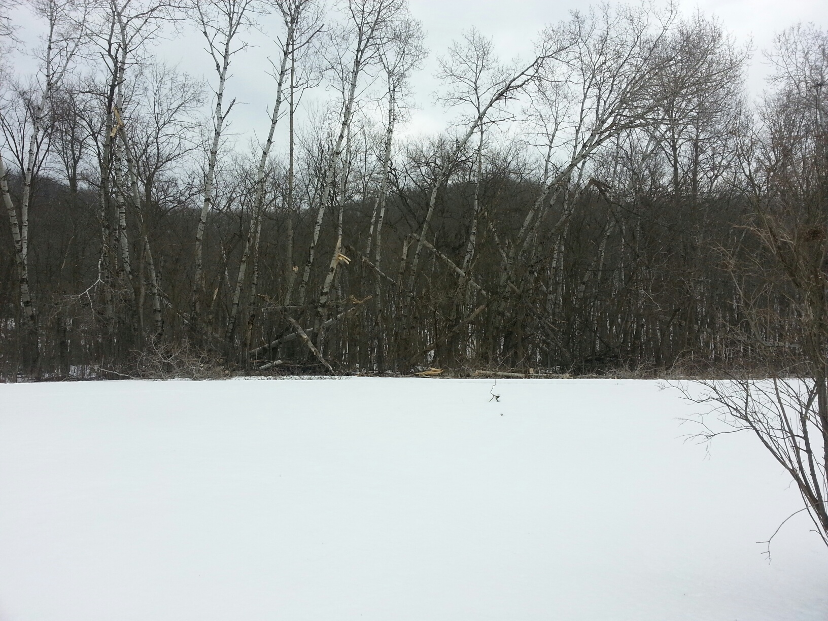

Here are some photos:
   / Wind Snapped Poplars #24
I think those would be pretty easy to drop actually. Your biggest issue is because of the lean they are going to barber chair pretty easy. That can get you. A small face cut and a wee bit of a plunge cut then into the back cut. Still they are tall enough that they can rotate on the cut or barber chair on you.
   / Wind Snapped Poplars #25
Boy what a mess. Some look worse than others. I'd start by cleaning up the stuff that is already down and dropping the ones that don't have tops hanging.
Once that is done start with some of the ones that aren't broke too high and get a feel for them if you are comfortable doing so. If things go well, work your way up in difficulty.
If at any point you are unsure...STOP.
There is a lot you can do now safely and cleaning up the mess will likely save you a lot of money if at some point you hire a pro.

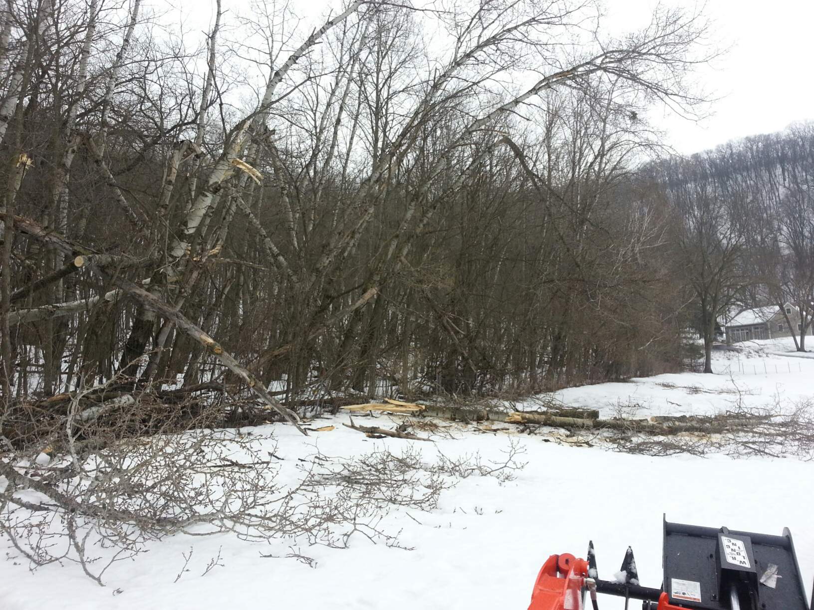

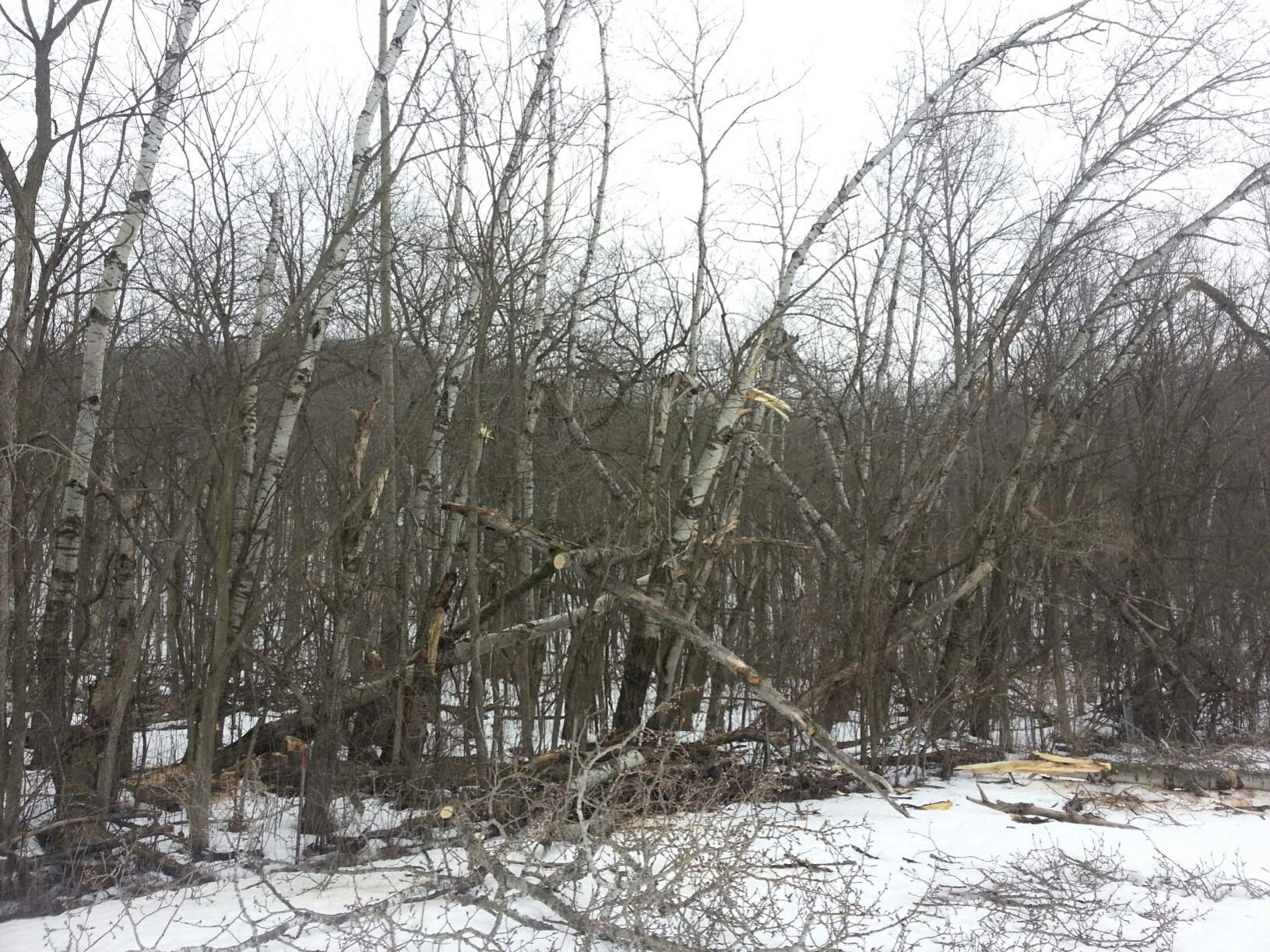

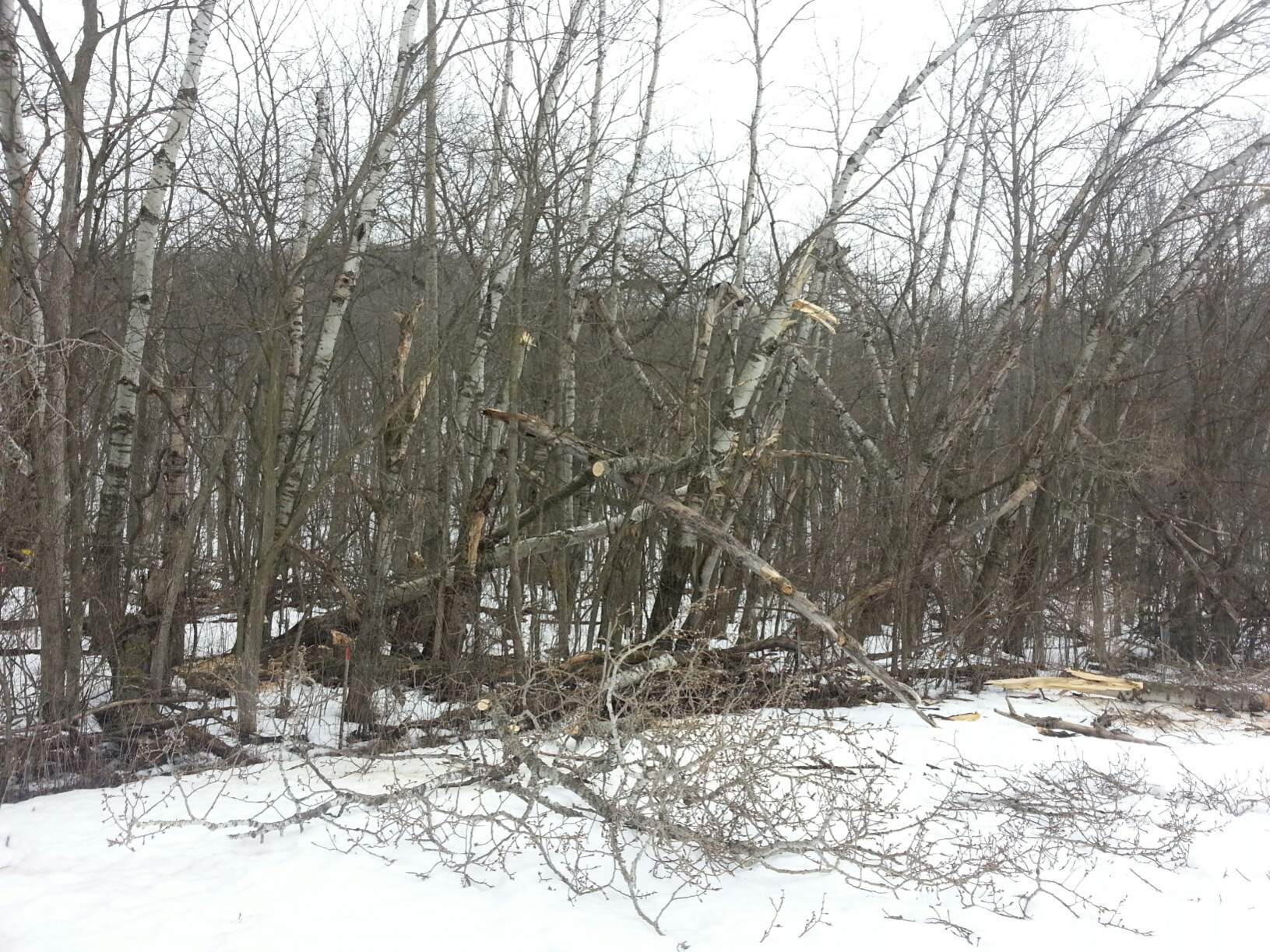

That is after taking out some of the easy stuff and pulling a few broken tops off using the grapple. There is a fence just on the edge of the pasture that I guess I'm just going to have to deal with getting trashed.
I've done some web searching on leaning trees. I understand the small face cut (smaller pie depth wise). I'm concerned that some of those trees aren't that big, It make be difficult to make a plunge cut in and then essentially making the back cut inside out as the width of the blade plus hinge will almost be the edge of tree. Maybe I'm misunderstanding the best way to make the cuts.
