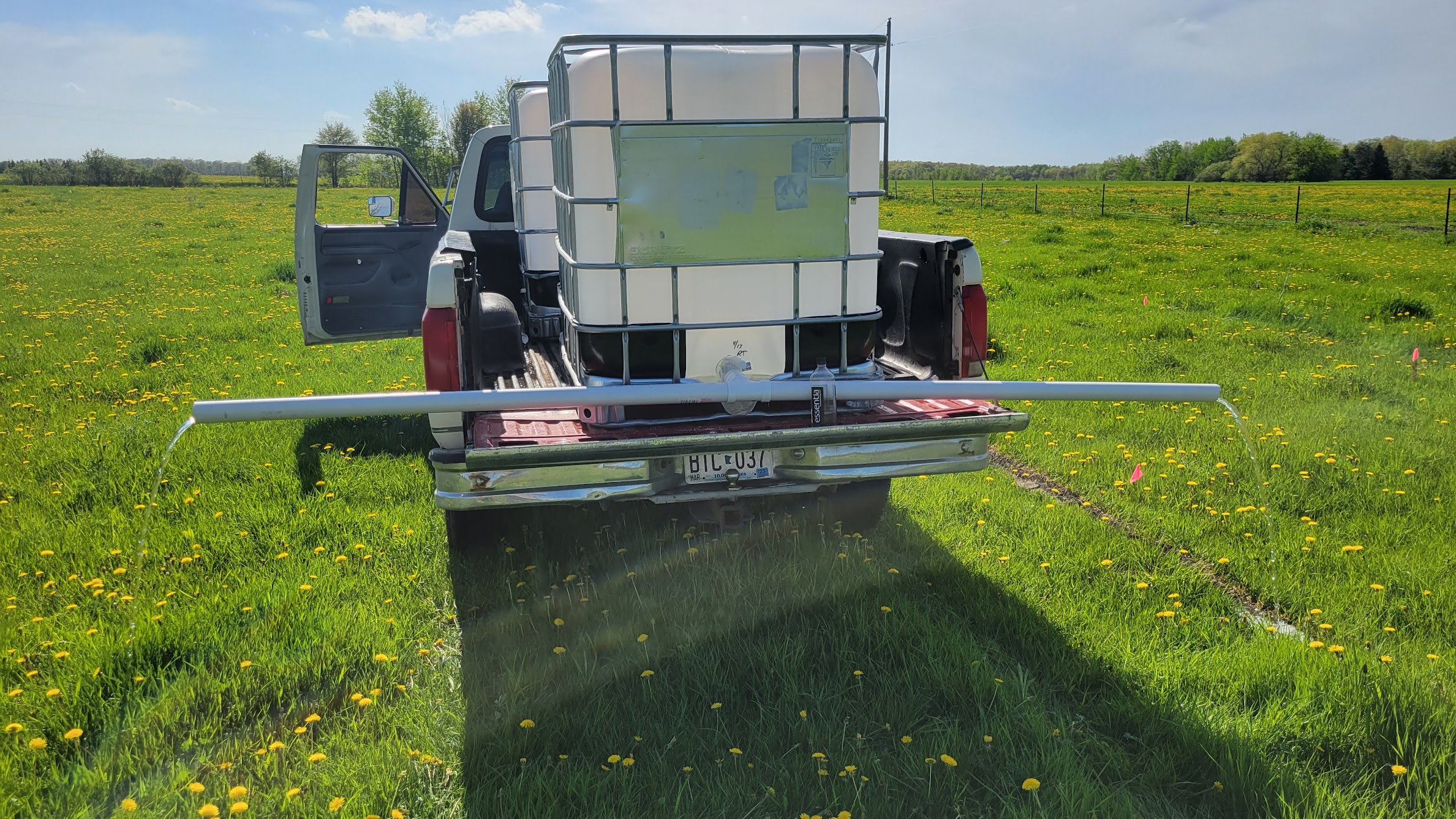

I did this quick and easy. It probably isn't he best option but can keep things from dying until you do get something else. I ended up attaching a piece of PVC supported by a rope to drive down next to the trees and reach over. I remote on/off would be great. I'm kind of considering building a small water tower to elevate the IBC to 5' or so and do some sort of drip.
This looks like what I would like to do. did you have a fairly small valve on that tote? I am wanting to craft some pvc monstrosity so I would like to get triple that flow if possible to water 3 trees at once.
