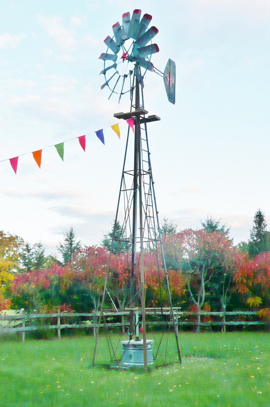

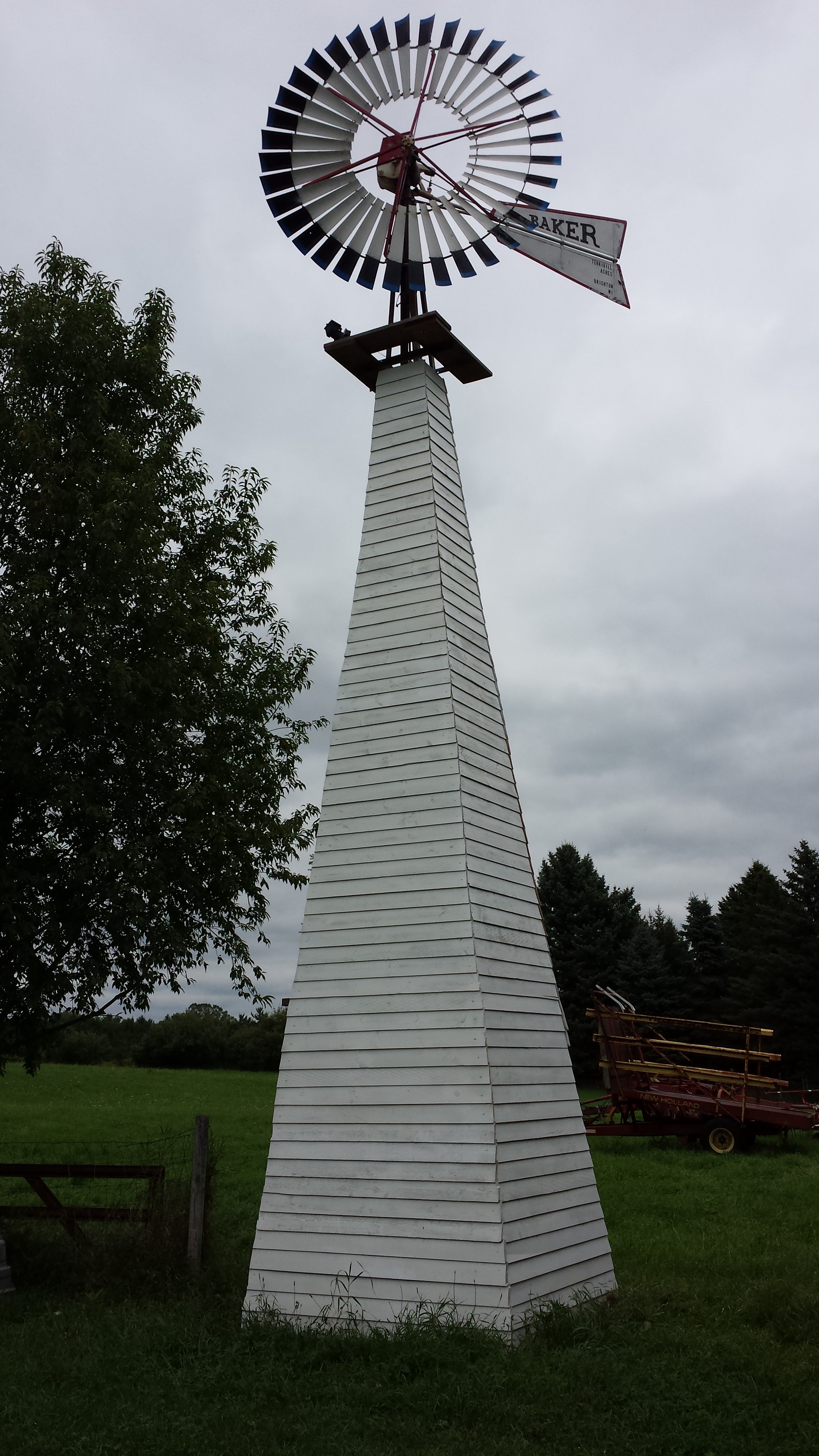

I have a F&W Star 26, 2 F&W Star 37s, a Star 24, and 3 Baker Heller-Allers, All up and running in the wind.
