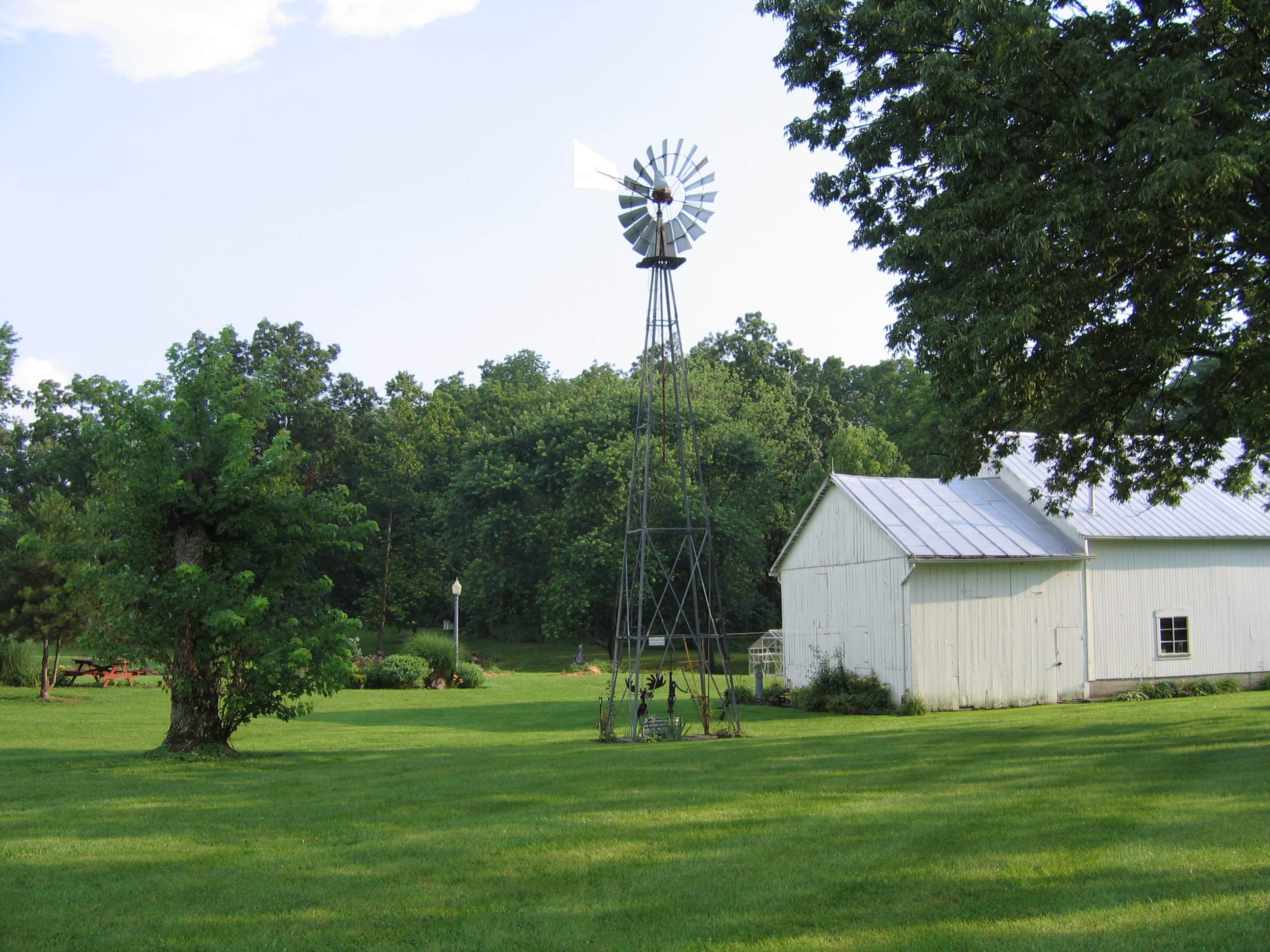

This project has been underway since the long rainy season kept me in the machine shed. This is a fully restored Flint & Walling Star 37 also called a Zephyr model. Because its has some extra preminum parts (bronze bushings in the tailbone and roll bearing on the drive shaft), its a "Super" version. I had to make a few new parts (oil pump, bonnet, pullout swivel) and fix a few others (tailbone, straighten tower angle iron, bullet holes in the fan) but she's a workin girl.
This is a back geared oil bath model from the late '30s that was popular here in Michigan. Bought it out in Cedar Springs and brought her home in parts.
You need a tractor and a loader to put these together. This is the second one on the property as a working mill. Another one just like this Zephyr is gradually going together in the shop right now. The fan fell down off the motor and got seriously crumpled.
Because of the economy and the demand for scrap metal, these old jewels are getting pretty scarce in the state. This is NOT Chinese crap iron....

Nice Job. How tall is the wheel and tower? Looks like about 10' wheel, on a 40' tower? You say it is working wheel? How far are you lifting? Love to see these old mills taken care of. Even if they don't/can't work anymore, they are just a great piece of art work when flying in the breeze.
For my wedding present my wife bought me a 8' Aermotor on a 35' tower. The Aermotor was new and was installed over an existing 40' drilled well. It has been sailing along for 11 years now, and always brings a smile to my face whenever I look up and see "Millie" running. :)
