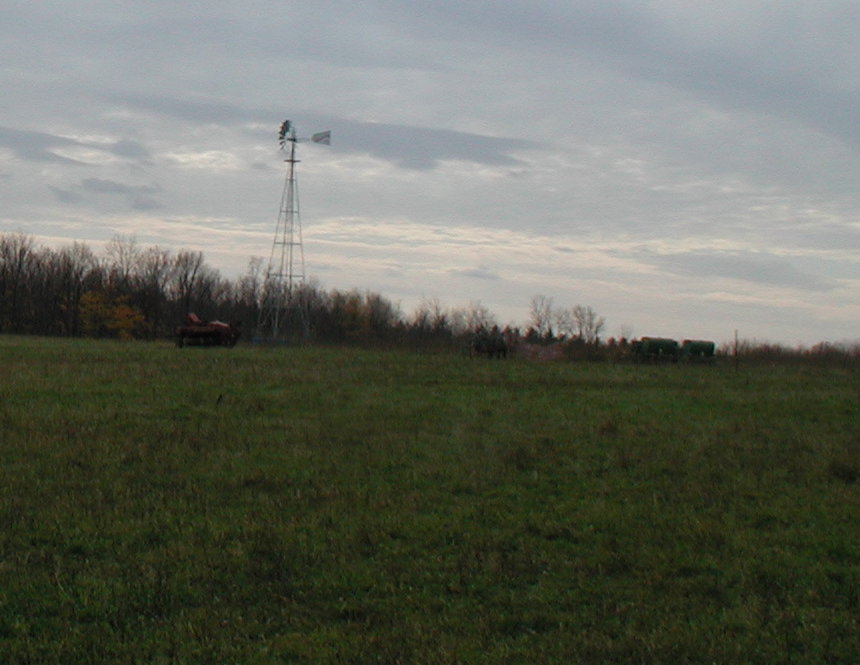

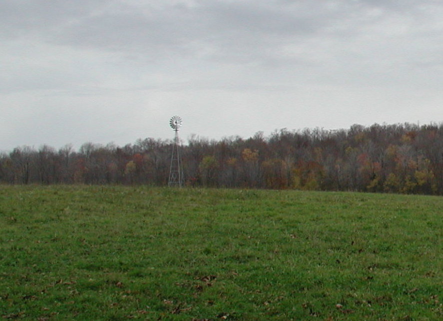

He is selling the property without a realtor. He did say in his ad that the windmill would be extra if purchased. I did see it work. He uses it to pump water into a large heavy plastic swimming pool tub and then gravity feeds it through plastic hoses to where his sheep graze. He initially wanted $8,000 for it but then lowered it to $5,000 when I told him I was not interested in the windmill pump. He stated it would cost him a good deal of money to take it down and reset it on his new property and thus sell it for his cost.
I really like the land and are mainly interested in this for future use. I would not have any use for the windmill now. If not used for months would this lead to the well water getting contaminated?

Here is a picture of the windmill

another

Nik, now knowing the rest of the story, the pump & tower are worth the $5000 that he is asking. If that tower is 40', then the mill looks like it is probably an 8 footer. I think that $5000 was material cost and the other $3000 would have been installation.
There should be no problems with the well, do to non-use. Windmills are usually pretty much trouble free. Change the oil every year and you should be good to go.
As long as the casing is up out of the ground about 12 inches, I wouldn't think that you would have a contamination problem.
How much elevation change is there? You said that you wouldn't need it right away. Believe me, it sure is nice to have water when your out at your property. I hauled water for the 1st 6 months that I had our rural property. After I got our 12' mill up and pumping, it was like we stepped out of the middle ages.:rolleyes:
We used a 1000 gallon stock tank for a few years, now we have a 10,500 gallon tank and thinking about building a 100,000 gallon concrete tank for irrigation.:)
Good luck with your decision.
