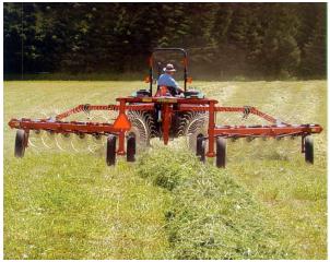

I like my windrows wide as my rd baler. If the windrow is uniformly made very little weaving is required for a uniform bale. I have never regretted buying my H&S hi-cap 14 wheel rake.If I choose to rake less hay I just move the hyd control lever. If I choose to change windrow width I just turn crank on the rear. Photo is of a rake similar to mine.

Wheel rakes come in 2 different configurations. The type I think is best is the one similar to the photo I posted with the rake wheels on the inside of the frame next to the unraked hay. The other style are generally the fold in the air(butterfly) type that have the frames next to the unraked hay with the rake wheels on the very outside. In heavy hay the frames block the flow of the hay which causes these clumps(bunches) in the windrow. Plus as these butterfly rakes get worn it allows the rear rake wheels to get closer/further apart affecting windrow width. I can narrow my H&S hi-cap down to the narrowest windrow setting for sq baling and still get no clumps(bunches) in the windrow. Another thing I like about my hi-capacity rake is I can adjust my raking width from 28' down to 5 ' and my windrow width from 3' to 5'+ which are totally independent of each other. On butterfly rake windrow & raking width are """"dependent on each other""""
