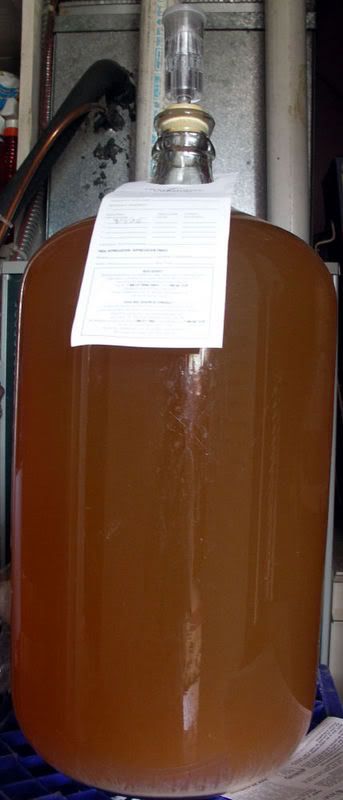

Here is a carboy of wine we made last year.
