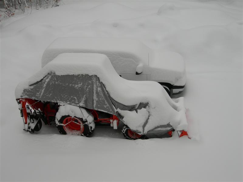

I have not seen any mention of the additive I am partial to. I have been using this for several years and have never had any problems. My tractor sometimes sits for four to five weeks at a time between starts at below freezing temps. I use the 805 to get the anti-gel along with the rest of the benefits.
