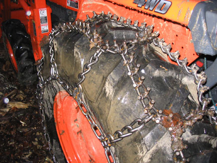

I have the Norse Boron caulk H ladder chains on the rears of my L4400. They are very aggressive but will gouge asphalt when they slip, for example when you are plowing and lifting the bucket(blade) into a big pile of snow, or starting to back up a relatively steep drive or road with a bucket full of snow( weight forward). On the whole very satisfactory

If you buy chains buy 2 link ones-better ride and traction. The Norse ones like Simon has are better the Tire Chains by TireChains.com ones I have.
