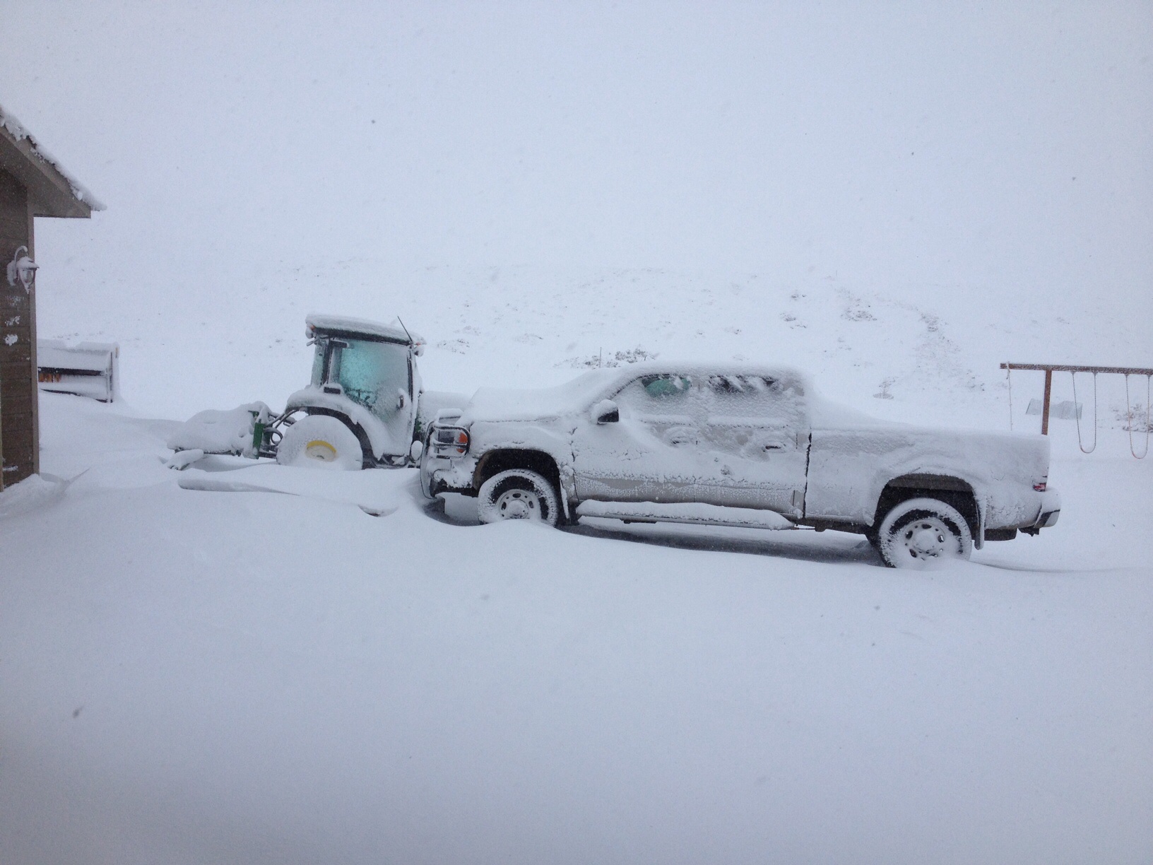

Here is a couple of pictures of my set-up;copied from another TBN member.I started with a skid-steer plate and added 3x3 tube steel.Plow pivots on 1in.bolts and floats via the chain on the up right.I replaced the cylinders and hoses.

Thanks for the pictures! That setup is sorta what I had in mind. I know there are a number of "plow builds" in this forum, but this one is probably the easiest to copy. Very nice! And for those of you that have built your own version of a plow setup, I also like those, but this one, I think, is probably a less time-consuming, build - for me. JMHO!
