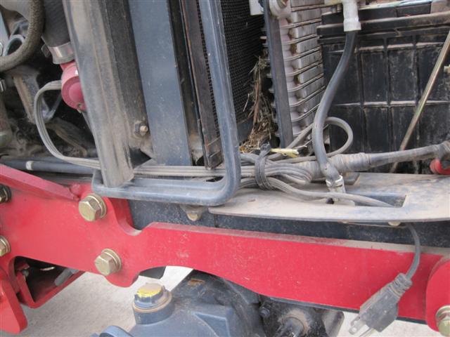

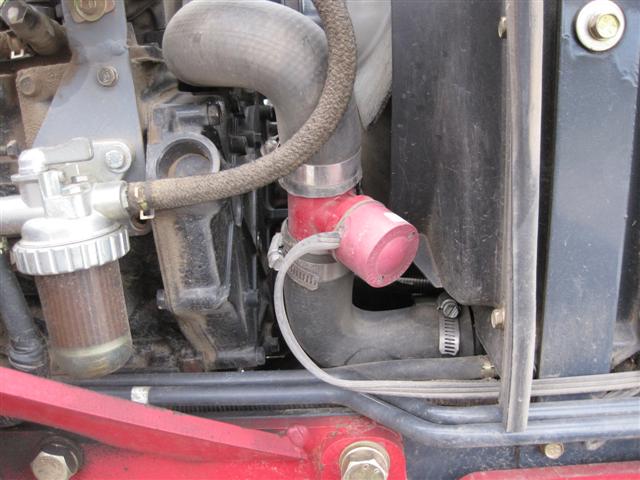

Here are a couple pictures of the block heater on my TYM 273. Due to the size of the engine, it doesn't take long to do its job. You can just tuck the plug-in away over the summer as you can see in the second picture. (I poked it out the hole for the picture) Not cold enough here yet!

If you install a block heater, you might also want to permanently mount a battery tender or equivalent and plug both into an octopus/three-way/etc. Then, one plug-in heats the block and warms and tops the battery.
