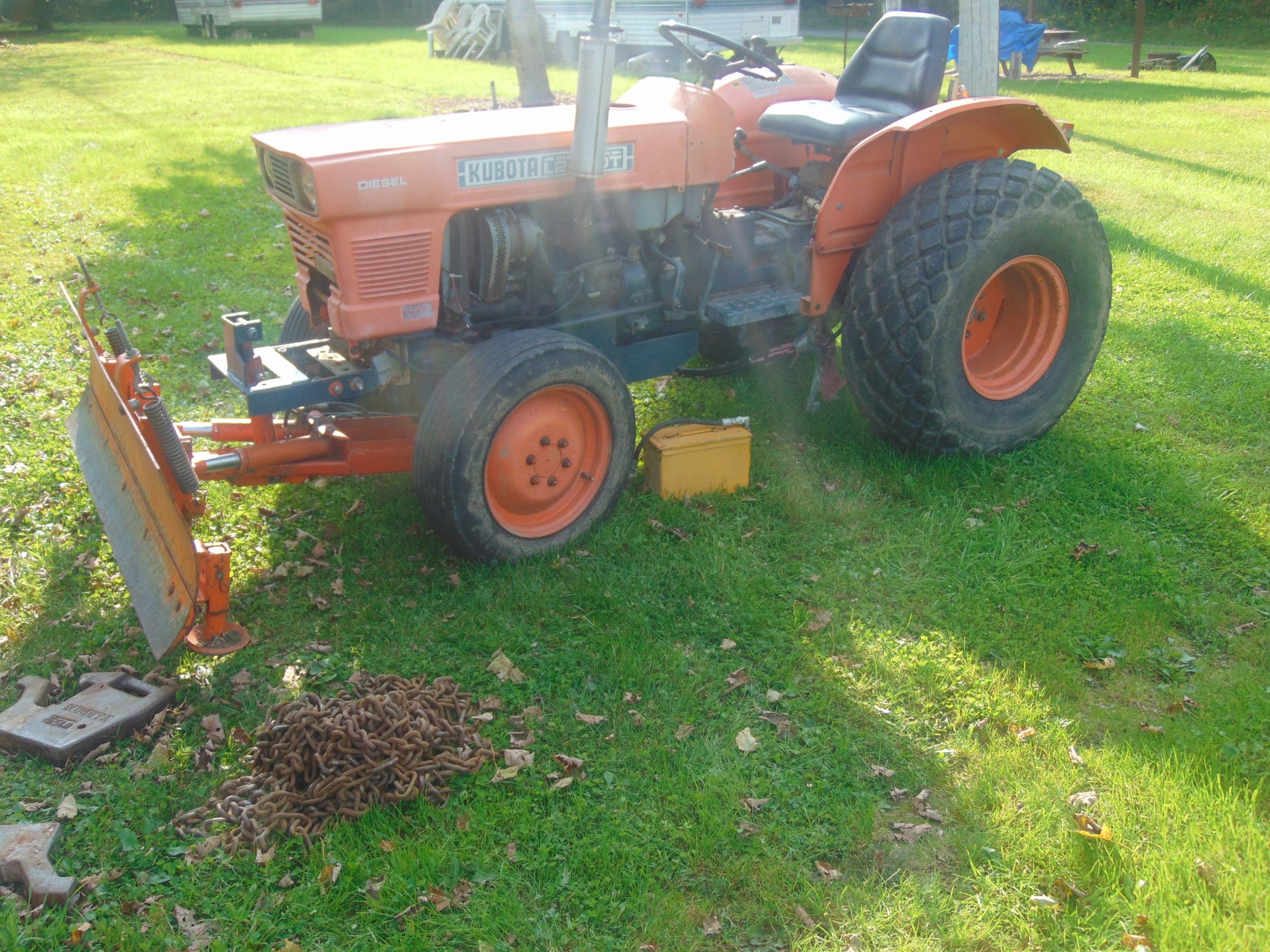

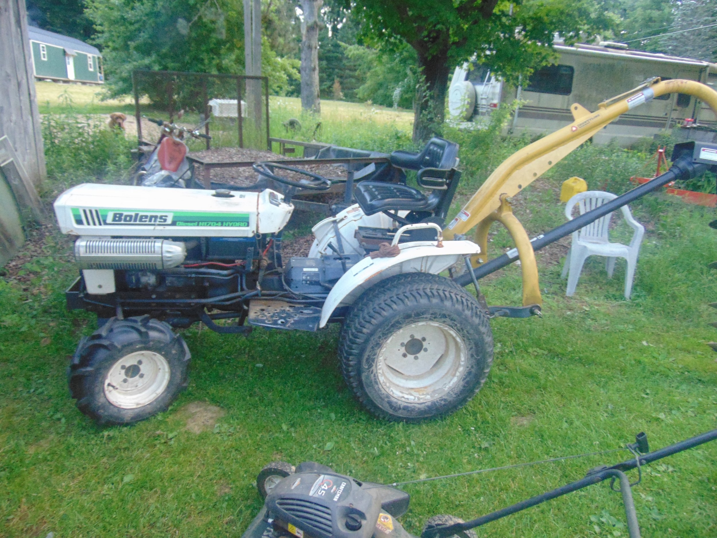

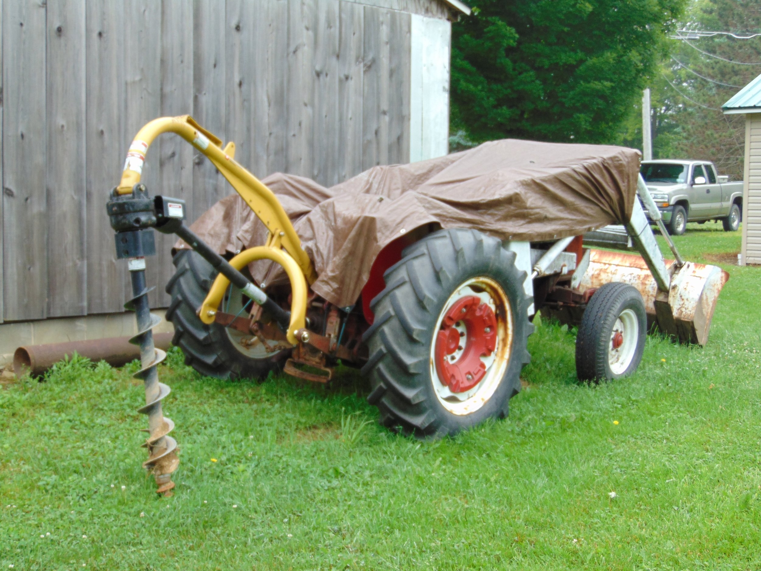

The battery came from Napa size 51f....the model tractors I have are listed under my profile pic to left.
