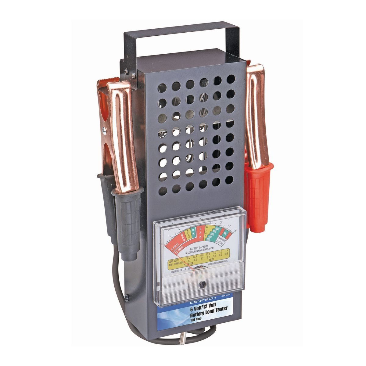

I use this to check my batteries:
Harbor Freight $19.99 Wally world $27
