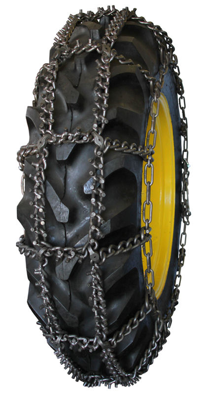

We usually only put chains on the rear wheels. The chains we use have lugs intergrated into them for better grip. Mechanic where we get our servicing done suggested we not use chains on the front tires. He said it puts to much strain on the front drive train. Found it interesting since he has front chains on all the big log skidders, but I guess they are designed differently from tractors.

I think Rusty that if you did not want to run front chains and relying on these tires as a compromise, nothing is going to give you better traction than the chains you currently have for snow work.
Arrow if I were limited to my property, I'd just run the chains for sure. They are amazing, but I'm in my 2nd year of having a small plowing "route" of 26 driveways and have found (so far) that I can get them done with just the tires, saving those expensive chains from a lot of "roading" for when they are really needed. There are a few driveways that with a heavy snow I might have to plow down hill, so far I'm good. Several of the drives on the fancier homes are paved and that's another problem and those "Trygg" ice chains are not a casual, side of the road installation like a simple ladder chain as you know.
