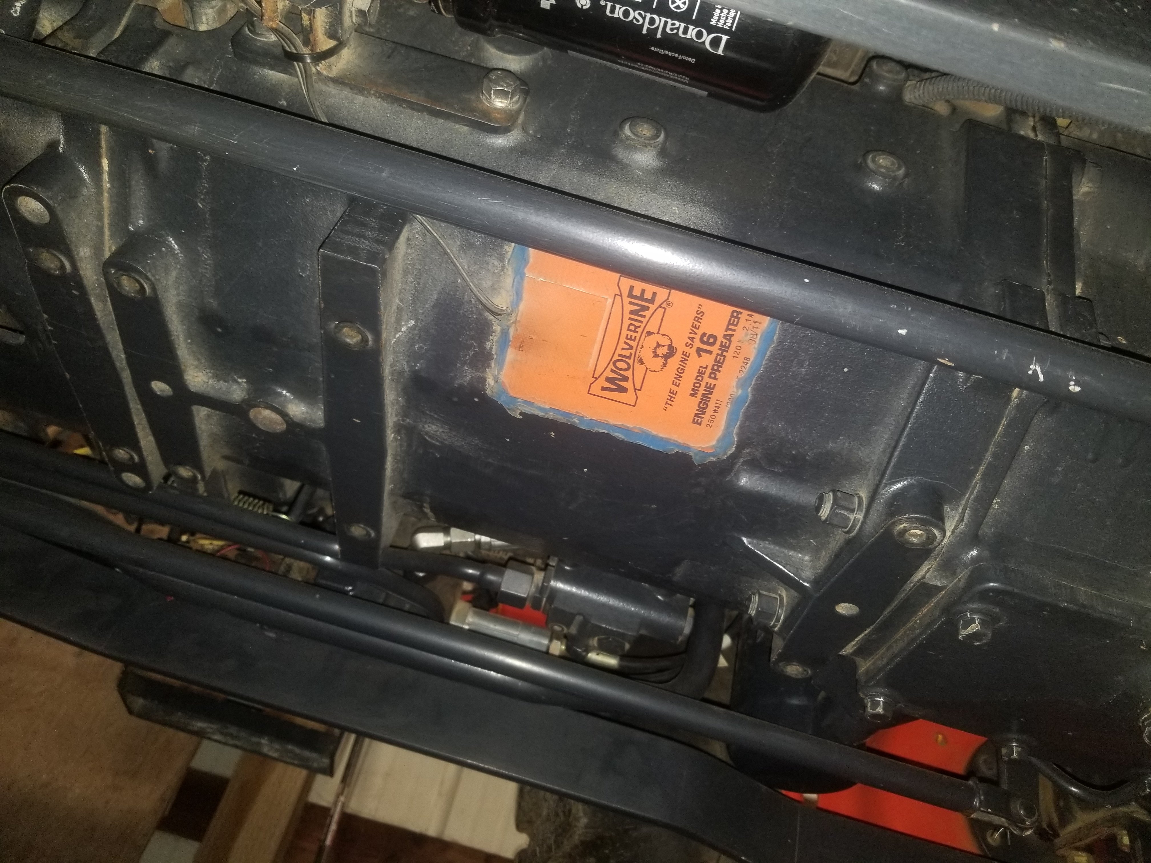

GRS - do you have a link to those silicone thermal matts and how you attach them? I have a magnetic heater and WIFI timer but it doesn't do much - looking for alternatives. Thanks in advance!
   / Winter Tractor Tips – How Do You Handle Snow, Storage, and Maintenance? #24
Mine were made by a company called Wolverene. I have no idea if there still arround, but alot of companies make them now days. Mine came with an adhesive backing. Once installed, i caulked the joint on the sides with silicone to prevent water intrusion. This was back in 2011, and there still working great. They put out alot of heat.

Are you referring to those peel & stick electric pads? Was wondering how well they worked. Any particular place you put them? Was thinking bottom of oil pan.

My oil pan is weird, it has 2 drain plugs and is raised in the center. Ill get a picture later on and post it.

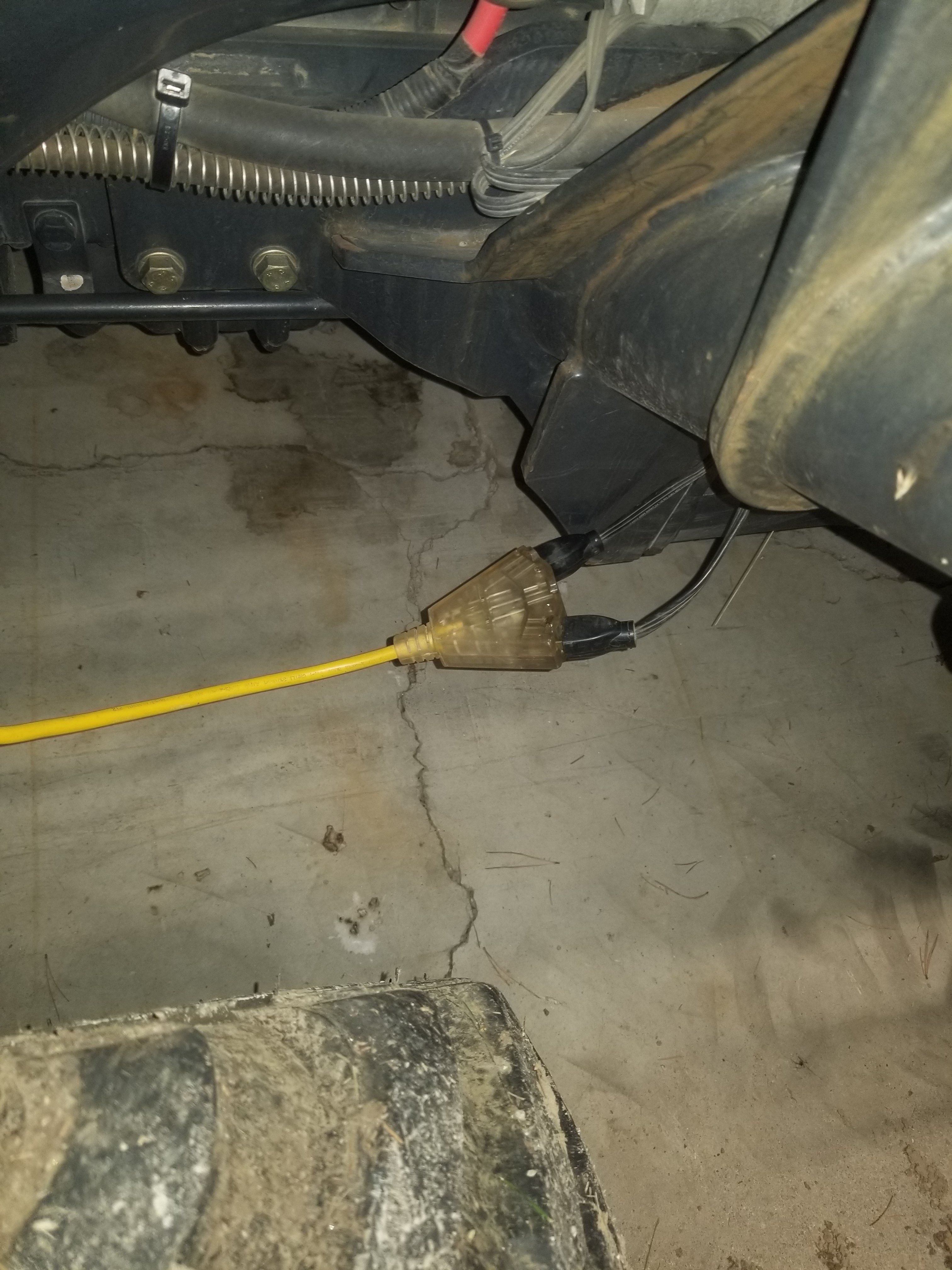

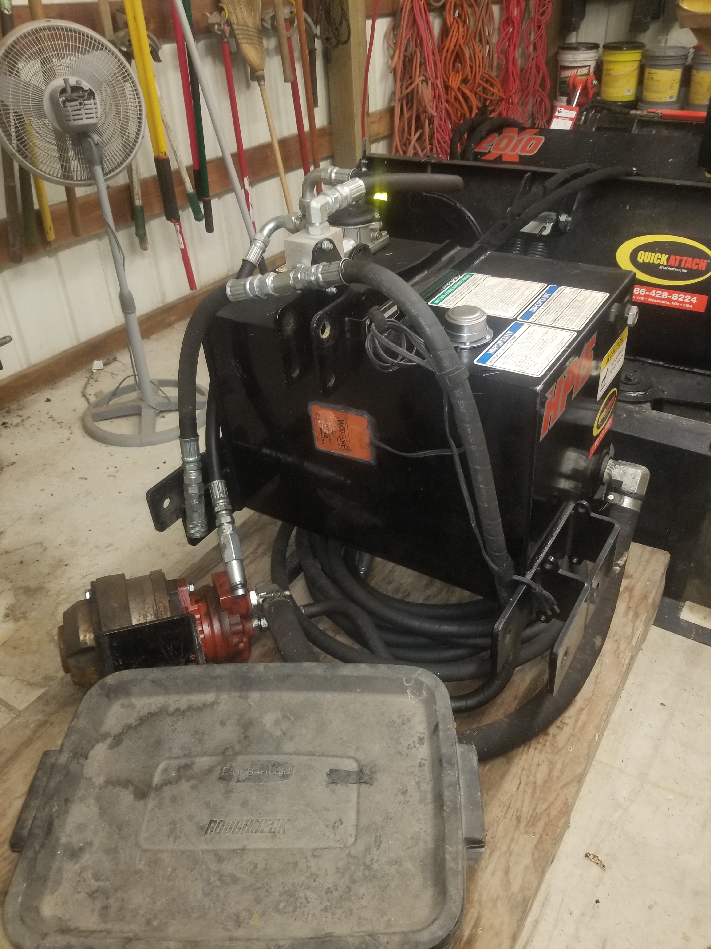

So i added 2 strip peal and stick silicone heaters, 120v i dont recall the wattage. Than i added a pad on the rear 3 point 25 gallon hydraulic oil can the powers my front snow blower. All 3 cords plug i to a wifi outlet that i control thru my phone. So i can warm the unit up before i plan on using it. All i know is ive done this since 2010, and the tractor starts way better and the hydraulic drive system is way happier when i heat everything.

Thanks GRS - I found and ordered this silicone adhesive heater today. 300 W and will use with my Kasa smart plug wifi. My oil pan is irregular so this should work well.

Ok, i took a few pics. I have one on oil pan, one on tranny to heat hydraulic oil and one on rear 3 point oil tank. If i dont use the hear strips, i can start the engine with glow plugs ( which i replaced this summer as 3 of the 4 had failed), but i would have to let it adle quite awhile to heat up the hydraulic fluid to where it wouldnt groan when moving tractor. With the heat, no groaning.
