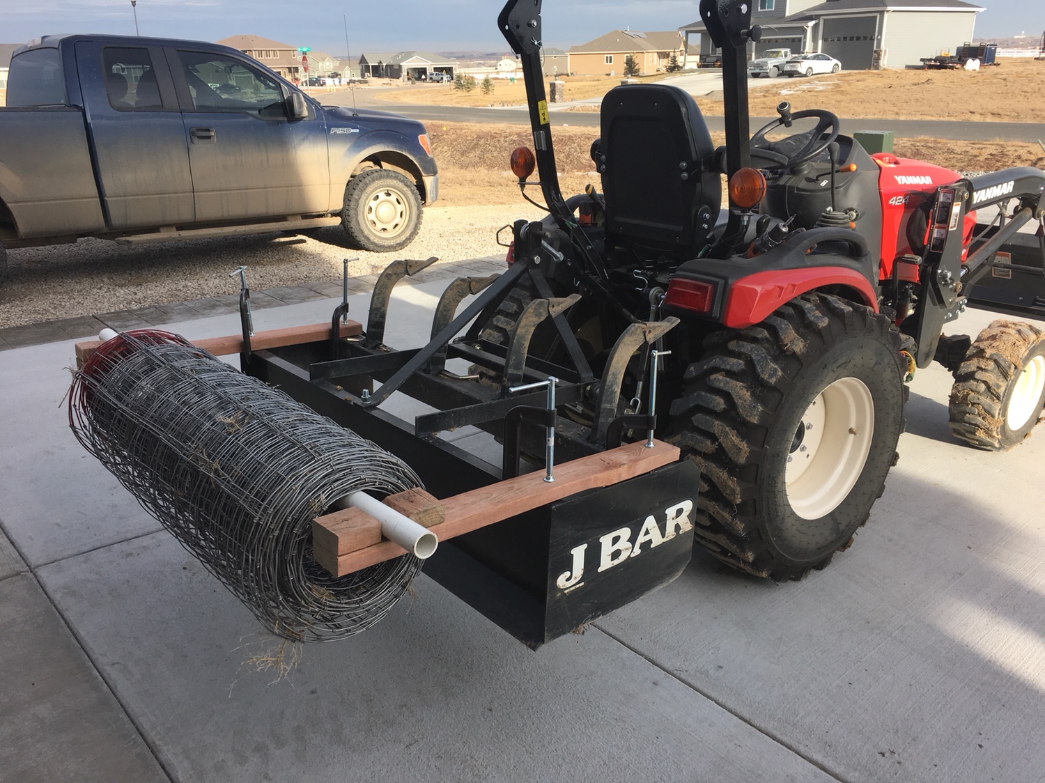

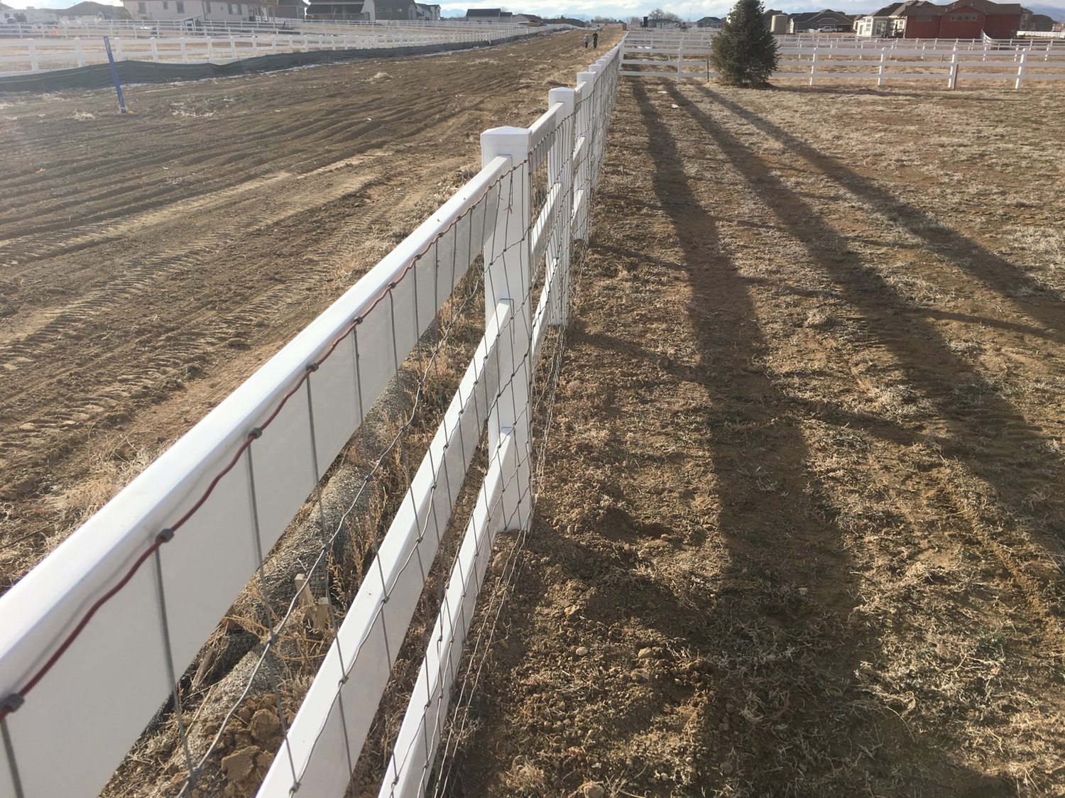

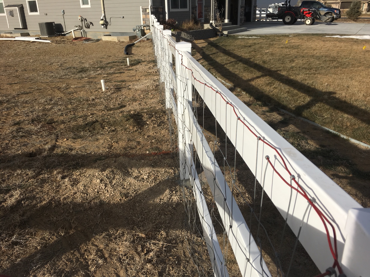

Used a different technique today, inspired by Sonny’s Tarter vertical spool I fashioned a makeshift horizontal spool/feeder off the back of the box blade. Unrolled the fence across the one side of the yard so it would want to roll upwards to the air, or out away from the fence in its upright position. Fastened section by section skipping every two posts, then going back to the skipped posts to re tension by hand then fasten. Not perfect but looks much straighter than unrolling by hand where it wants to curl towards the vinyl fence.
My “spooler” if that’s what they’re called:
Section unrolled by hand while trying to keep roll of fence vertical(horrible technique in retrospect):
Section section unrolled with tractor:
Now to hopefully unroll and fasten the rest of it tomorrow. Thanks for all the replies about adding crimps, I will try that as well.
   / Wire fence over 4' tall 3 rail vinyl install? #13
DieselMachine,
Your spooler is pretty smart. Wish I had thought of that.

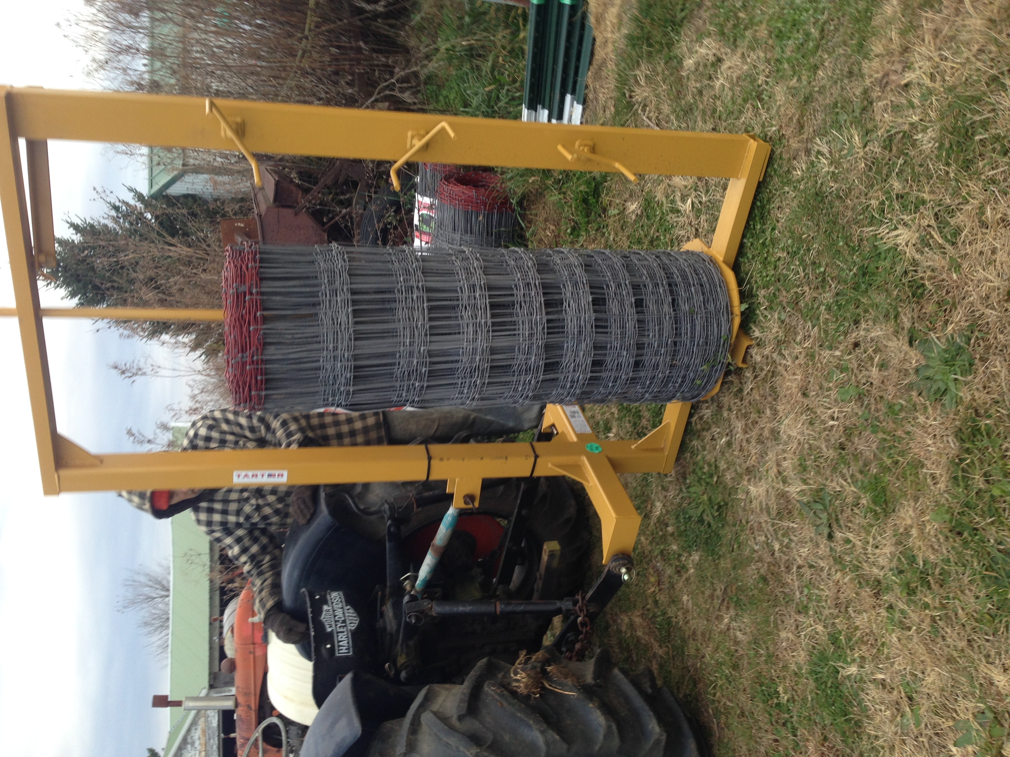

I just posted pic. of mine to maybe give some ideas to make something to do the same job!! LOL!!!
1 year ago this Tarter dude was around $525., and has more than paid for itself in the year of use!--still have 1,500 feet or more to put up.
When you reach the end of roll, swing clamping bar around to grab wire, then drive forward to tension wire, then go back and install clips.
Another person want's us to put up some wire for them when we get ours done. thanks; sonny

View attachment 534670Don't know why it turned on it's side, BUT, this is the only way to unroll and tension woven wire!---I am currently putting up the red brand stiff myself, only on steel post, and found nothing else to work.
This thing is slick and easy! thanks; sonny

This unroller is the only way we found to work for us in getting the big rolls up.--Can't go wrong, and they will last forever, (one time investment).
I was going to have to make something to do the job,( time did not permit it), but wife found this on the internet, price wasn't too bad, so as you can see she got one ordered for us!! thanks; sonny580
