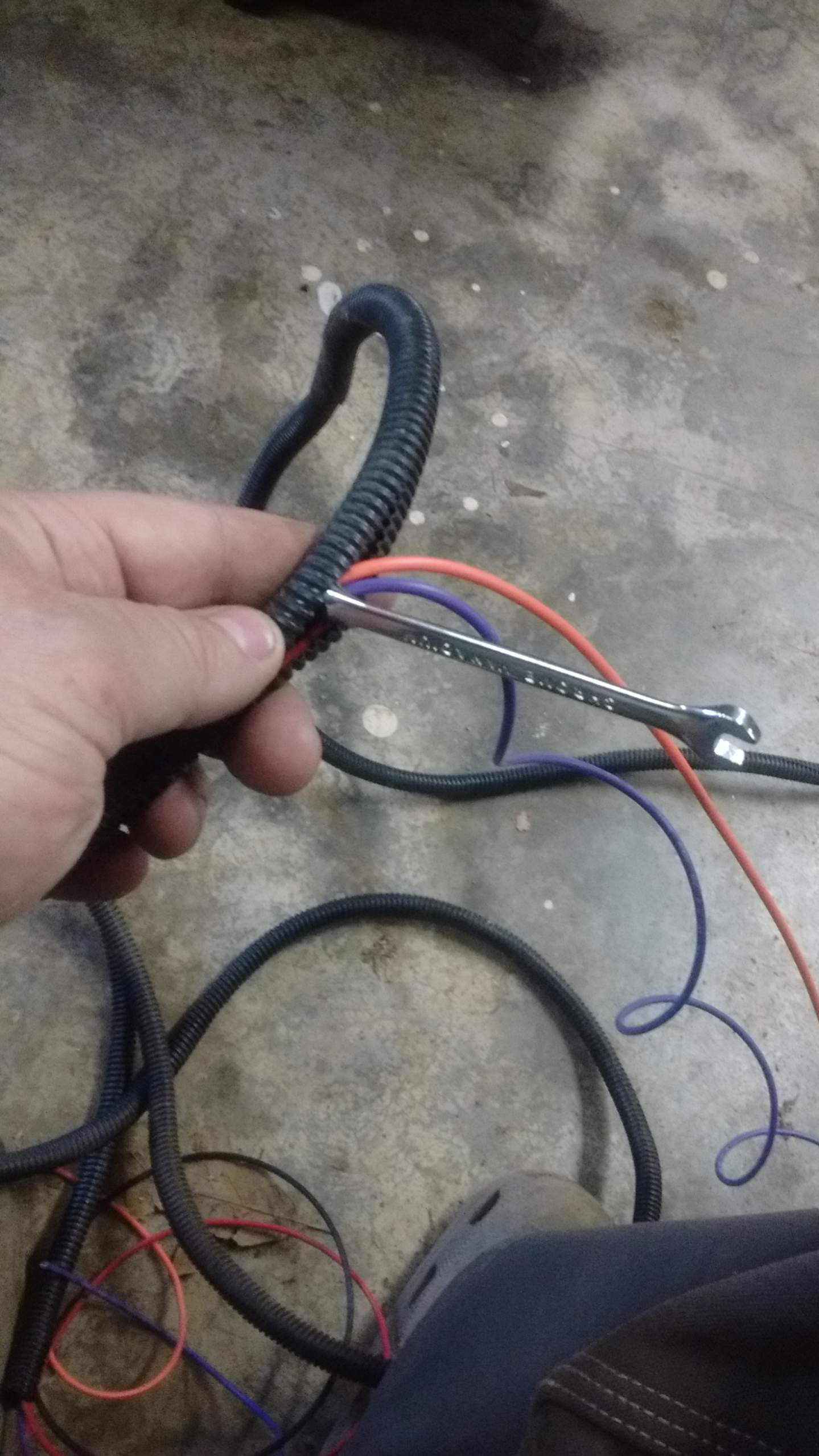

Well just a followup.
I ended up "finding" the length of split loom, plus about 5', for what I needed for my M4700. It was in a pile from the previous owner I had not yet cleaned out.
So I ended up using that for my M4700. However, maybe because it was old, the plastic did not make it easy to feed the wires into the split loom until I threw a box wrench into it. Fed the wires through the box wrench, pull the box wrench forward opening up the split, just like laying cable with a tractor.
   / Wire loom for LED lights - recommendations? #24
That's a kinda inventive solution!! I'll have to remember that one!!:thumbsup:
#25
Thanks. I was trying to devise a piece of pipe w/ a washer or something on the end when I grabbed the box wrench.
