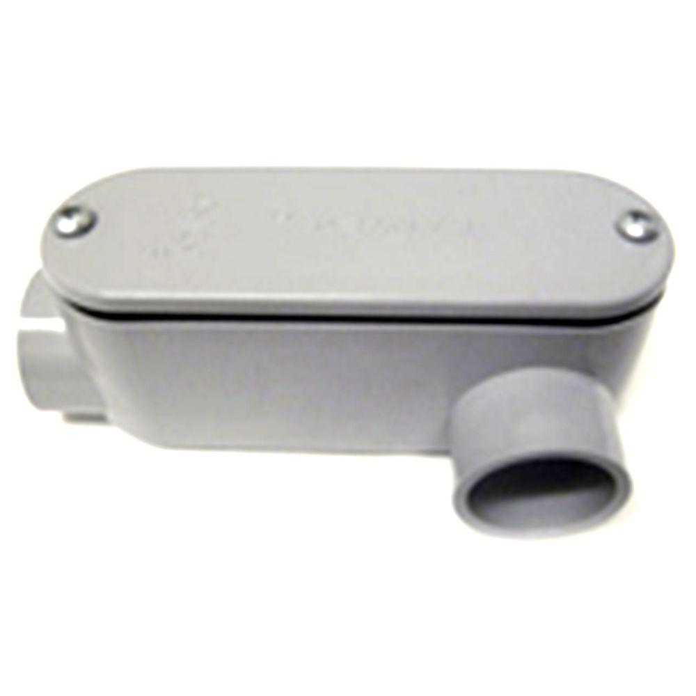

To get from my panel to the outside of the wall means making two very quick 90s that make conduit impossible to pull wire through. I wouldn't try it with 12/2!!
For quick bends, use one of these. They come in several different configurations and are available at HD & Lowes: conduit-fittings-90 deg.jpg
