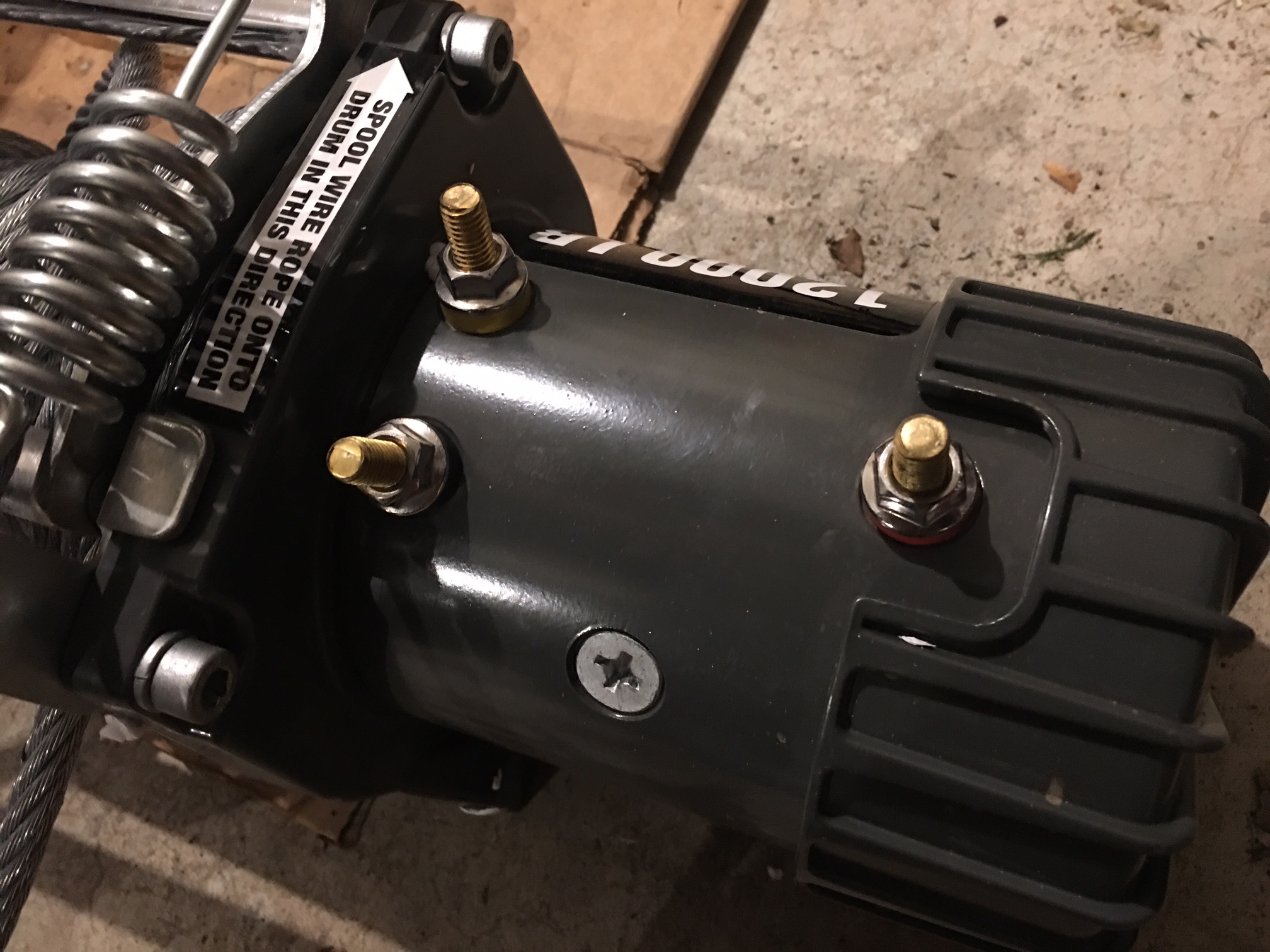

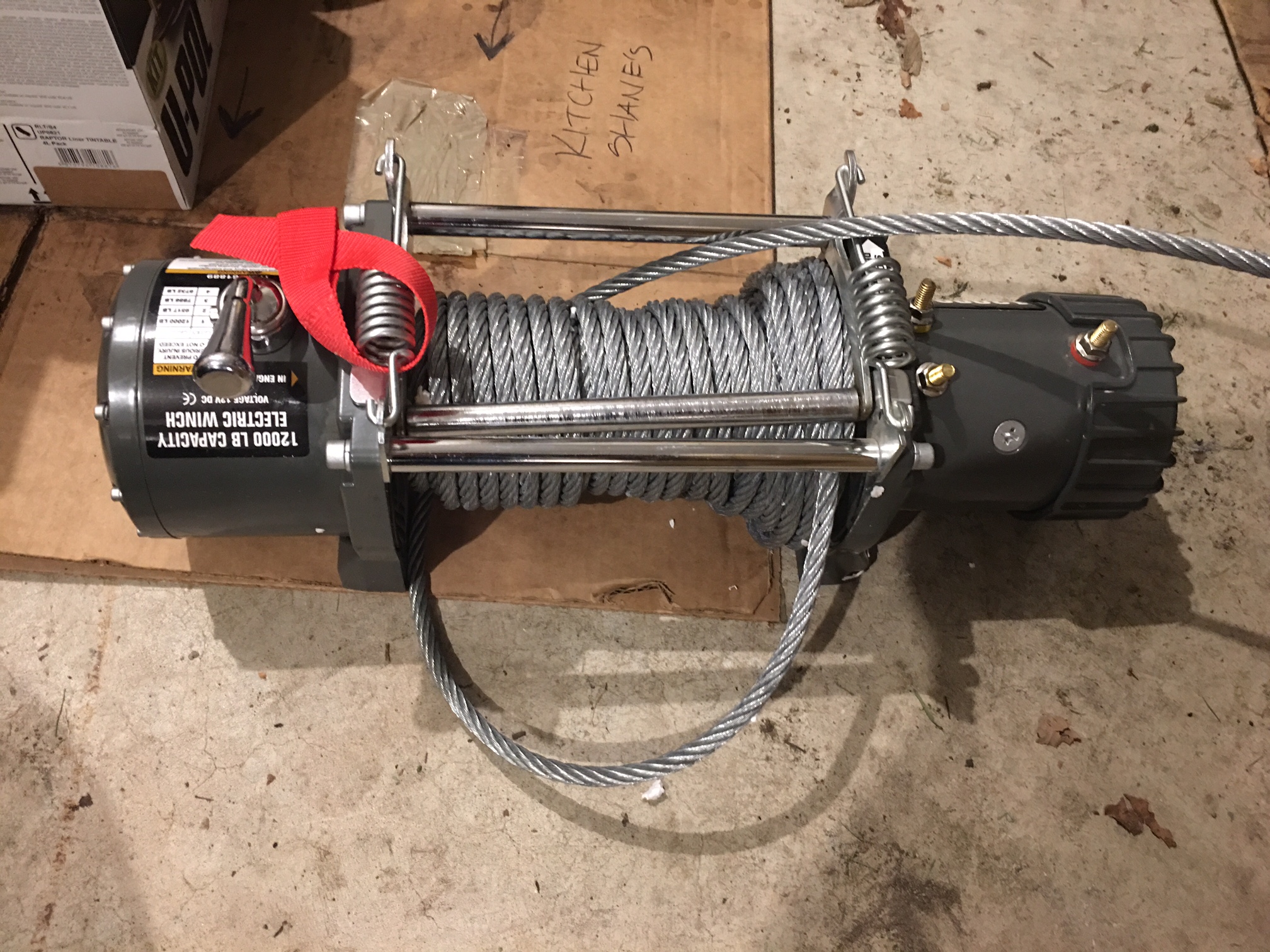

So...
1. Battery or wired to truck through 7pin?
2. Thoughts on best way to wire it to power and options for controllers. Remote attached or wireless would be fine.(I see wireless for $15, but I suspect I have to wire them into an existing controller which doesn't exist in my garage at this point.
3. Given this thing weighs about 60lbs as is and by the time I get it wired up etc, it will weigh more, I suspect I'll mount this permanently to my Gooseneck. If there are any issues, advice, etc. I'd appreciate it. I read another thread showing different connections and it seems as though most people are hooking it to the trailer with 2" receivers. I don't know how this would work for this winch, but, I'm certainly open to it. I just think that between the battery (if one is needed) and the winch, it is going to be running close to 100lbs. And while it wouldn't be an issue now, I know that in a few years, I would be leaving it at home, because it was too hard to install.
4. Any advice on placement would be helpful. Certainly bed level would be preferred, however, being a GN, the space at bed level is reserved for 'not knocking off the fenders of my truck in tight turns'. I was thinking about mounting it on the top of the GN and either running the cable through a pully at bed level or simply pulling from the GN top location.
I'd appreciate your thoughts on this subject.

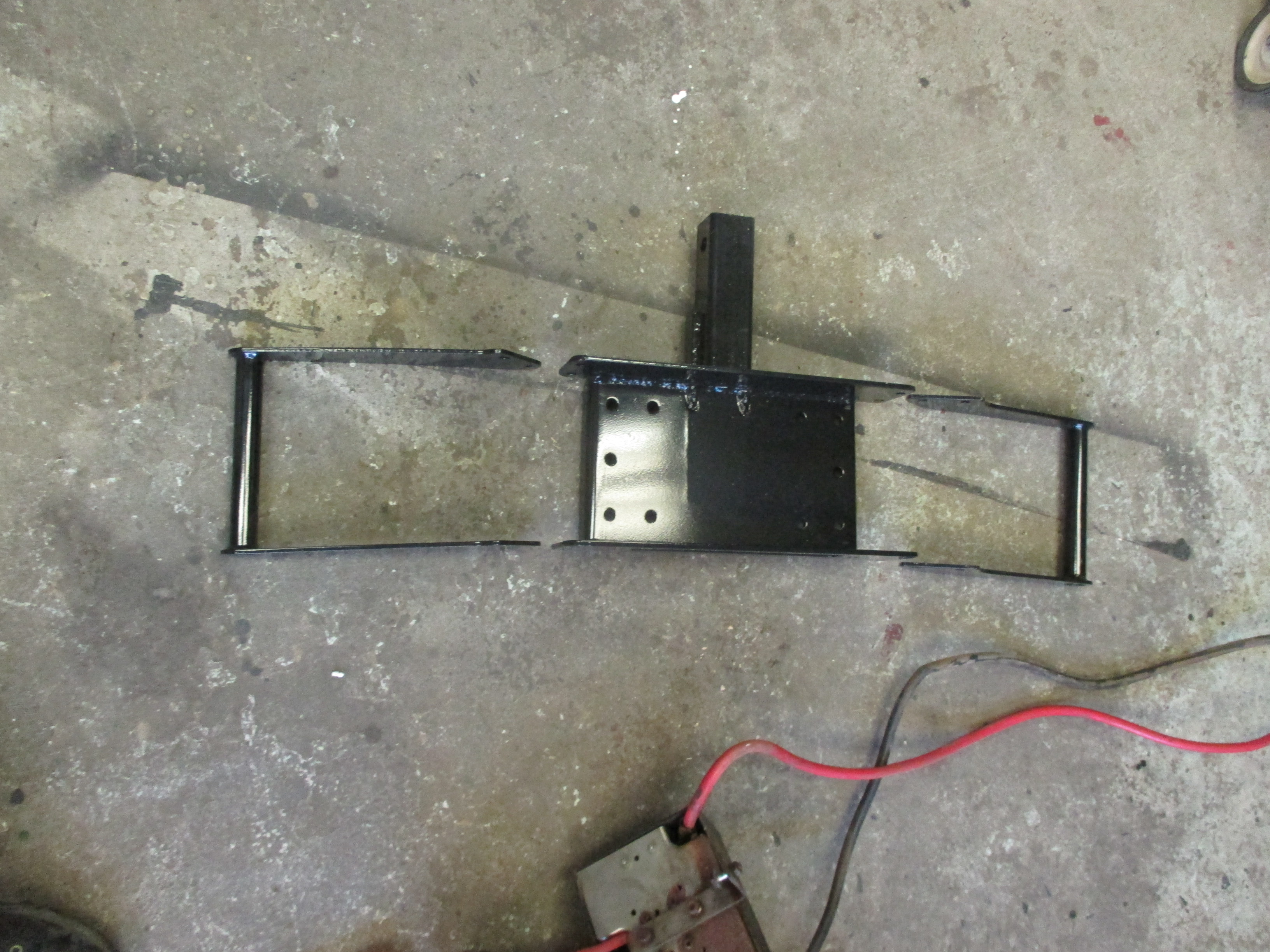

I bought one the first time they came out, 6 or so years ago, and bought their receiver plate that can go in my 2" trailer receiver on my 3 point trailer hitch.
Since you are mounting it on a trailer and can only run it briefly I'd suggest a separate big battery next to it with the battery being charged from the 7 pin, or you are going to need some big wires running from the front of your truck back.
I also have bought 2 of the HF 2500lb winches. On sale BF for $49 by the way. So far what I've done is patch together a cable and mount system so I can move them around between tractors and trucks.
I use U bolts to fasten the hitch to my trailer railing or a couple of 2x4's at the front of my truck bed.

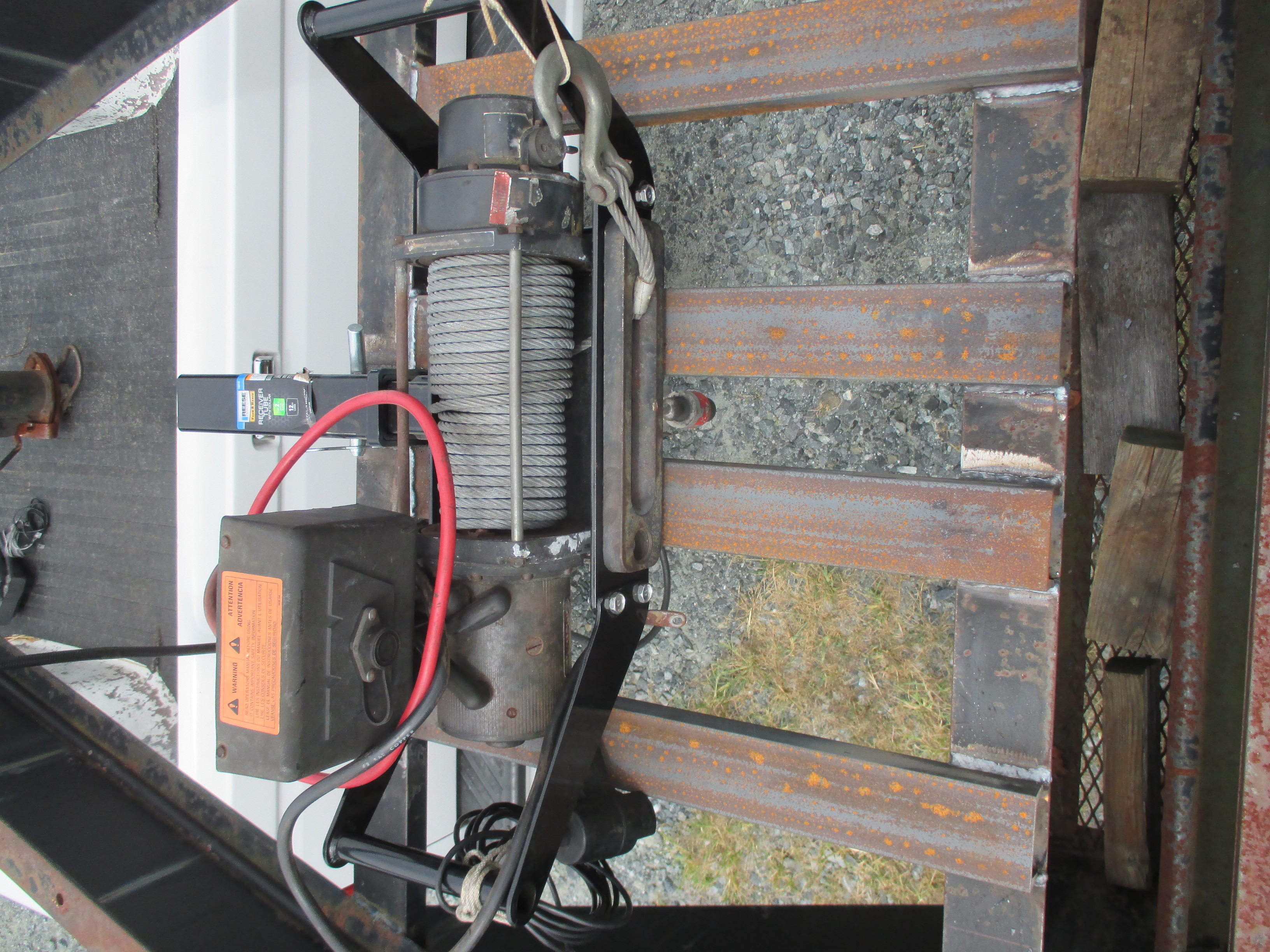

how i attached mine to the top of my GN
