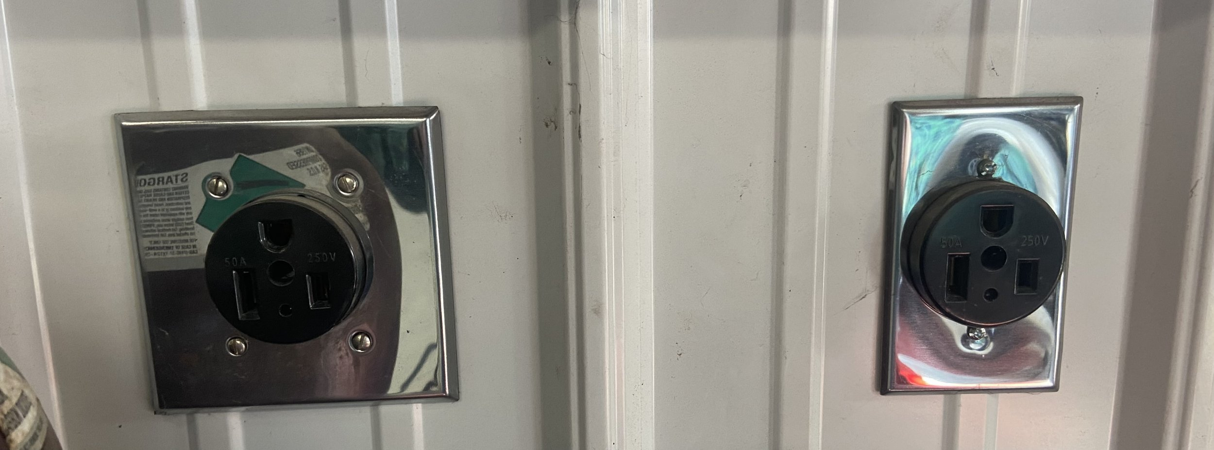

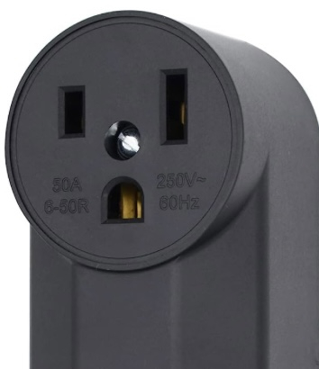

OP. I had to look that NEMA 14-50 plug up and it is a four wire, commonly used for electric ranges and dryers. Welders come with a three prong, and need this style.
I could be wrong about how the Squarewave powers the fan, being an inverter, but my old tombstone has a 110 volt fan. My Lincoln 256 has two 110 volt receptacles in the rear and that machine is not an inverter. You have to have a neutral for that to work, so the third prong is acting as the neutral. When I moved out on my own, I took my tombstone that I had bought in1972, at age 16. When I wired it at my new house, I did not know enough to get the correct duplex breaker and just bought two breakers and installed them. The fan would run, but the machine wouldn’t strike an arc. My electrician friend explained that I had to move a breaker to the other leg, as I was only feeding it 110 volts from the same leg. Problem solved. When we built our new shop in 2016, we hired an electrical contractor. The plug on the left is 60A for my 256 and the one on the right is 50A for the tombstone and Squarewave.
