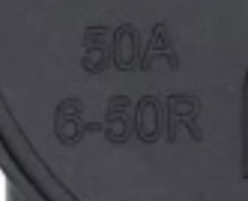

I believe that was my intent, given the first picture. If it’s not wired correctly, the fan won’t work and the welder will overheat. Hence, that makes it relevant.

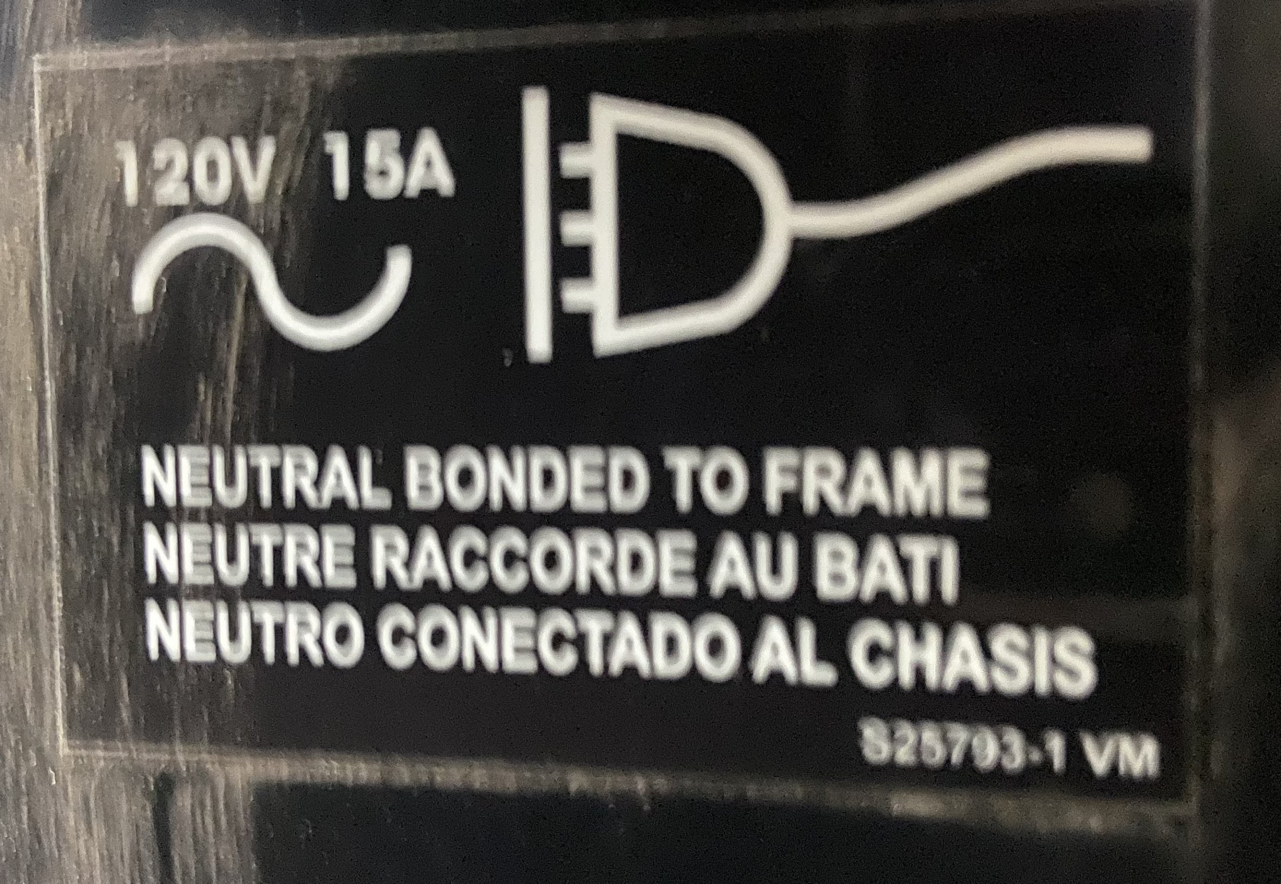

Any welder that uses uses the ground as a return is not to code. Using the ground as a neutral, as a return, used to be pretty common in certain devices. Welders, stoves, ovens, and driers being the most common. This practice is no longer practiced (didja get that?).
Eric
My Lincoln POWER MIG is six years old. This label is posted next to the 120V receptacles on the back. Welders are not stoves and dryers. All done here.
