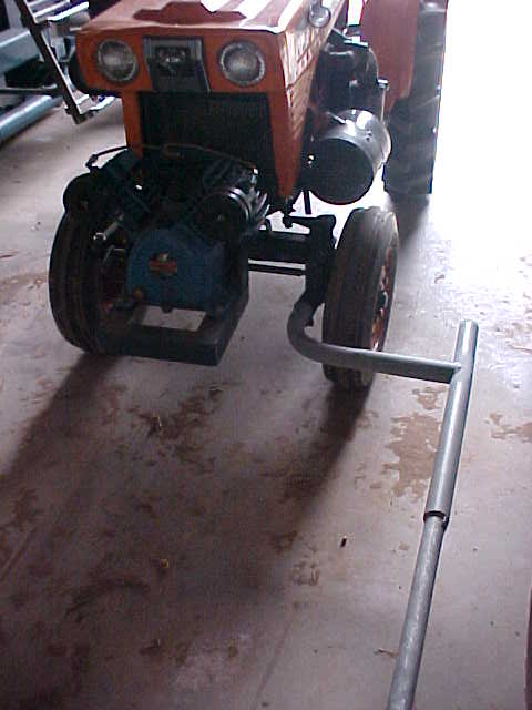

allenr, 2 questions.
What is the (air ?) compressor doing on the front crank ?
What is the 'long strip of brass' joining your positive cables to the alt ?

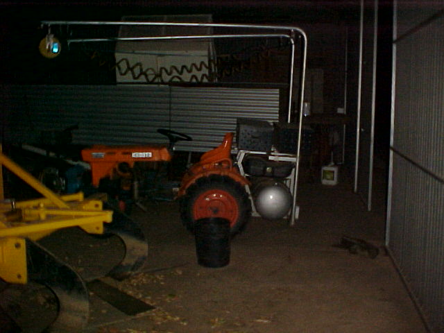

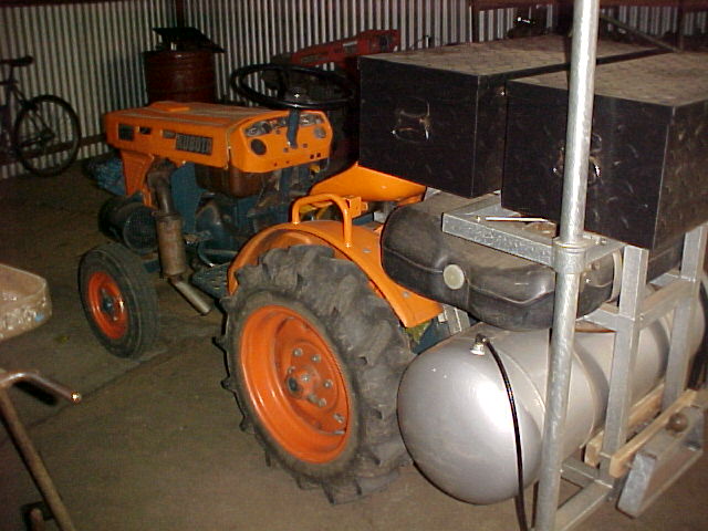

I'm building another compressor tractor to operate air snips for pruning my vineyard very similar to No 1 pictured below.
It guides itself along the row to its left, a remotely operated air cylinder engages and disengages the clutch and the overhead booms open out to allow 4 pruners to work on 4 rows.
There are some commercially manufactured units (I've still got one in the back of my shed) that had a 7hp petrol engine, 1 fwd speed via vee belts, jockey pulley and a final reduction chain drive.
The brass strip was only there temporarily, it's the shunt bar for an ammeter to check the alternator output. Probably can't see it in the pic but there are two little lugs near each end where you clip om the ammeter leads.
