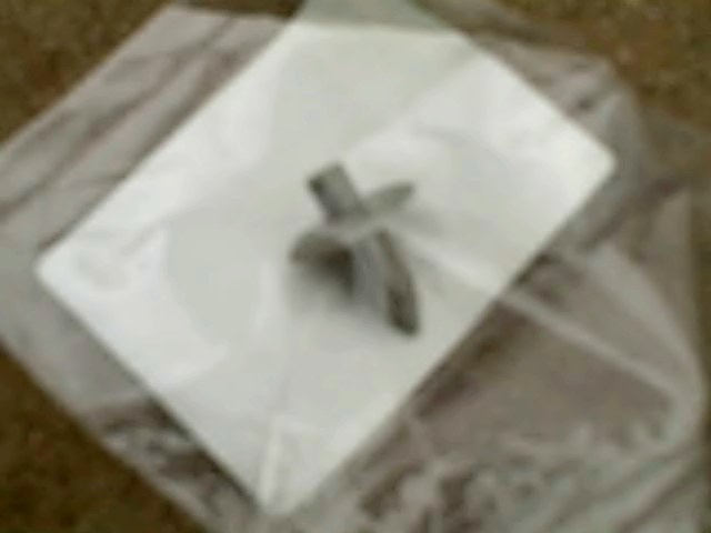

I had to remove all the ceiling retainer buttons, by pushing in the center to free them.
I thought you had to use an awl or needle type tool to PULL the center pin OUT of the retainer button instead of pushing them in to release the buttons?
   / Wiring for rear work lights Kubota L4200 cab #12
I used the head of a finish nail to push in on the center of the button. This relieves the tension, then you can pull the whole button out. I also bought some additional buttons, because you do wind up destroying some. If I recall, they were about .70 cents each. Kubota could save a lot of aggrevation if they left the wiring harness exposed in the bracket.
   / Wiring for rear work lights Kubota L4200 cab #13

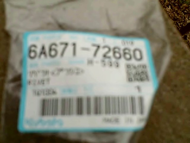

Tried to post a pic of the headliner button for my B3030, as well as the part number. Both came out a little fussy. The button depicted is new in the package and shows what it looks like un-tensioned.
   / Wiring for rear work lights Kubota L4200 cab #14
Thank you sir for clearing that up!
