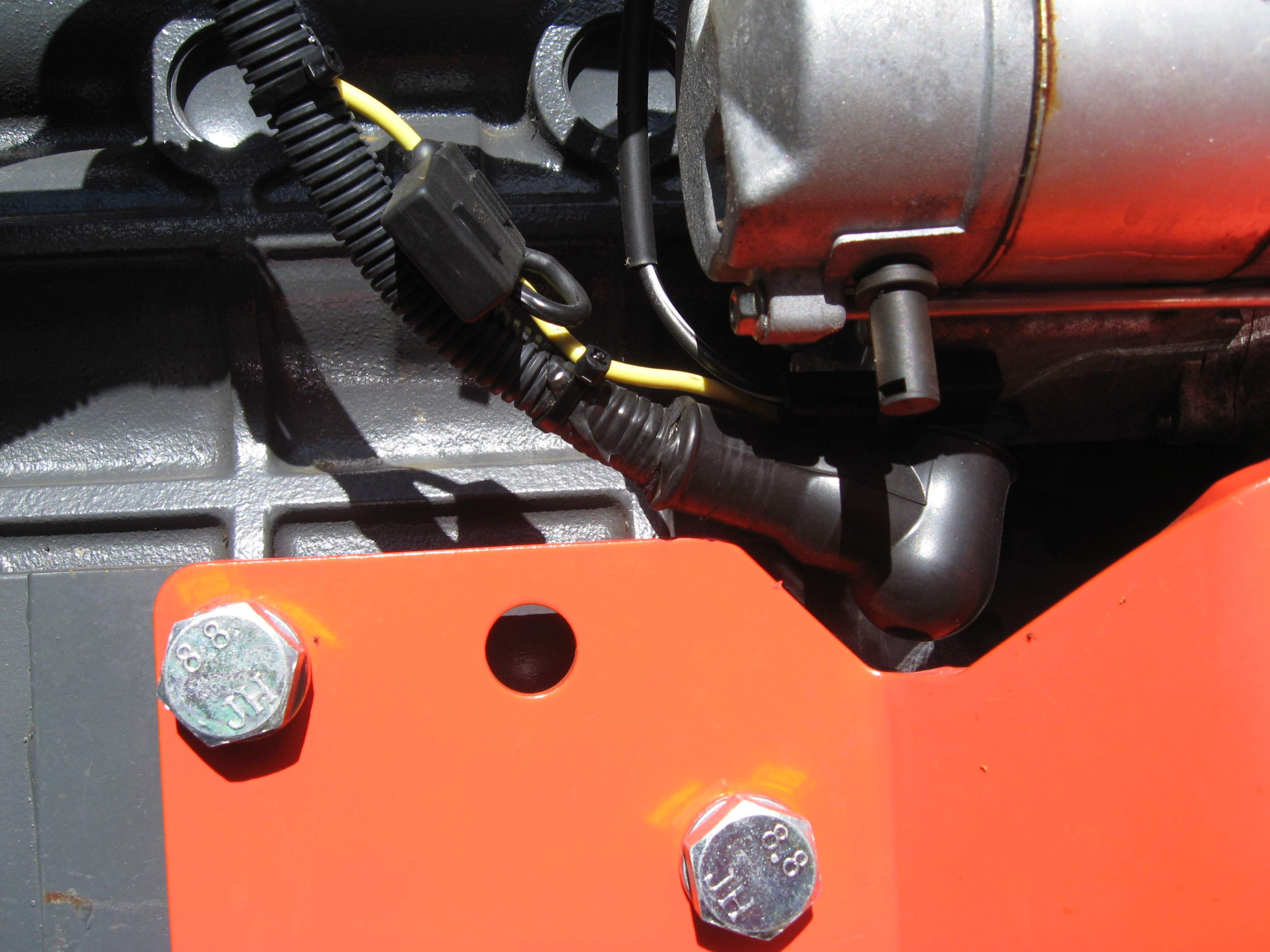

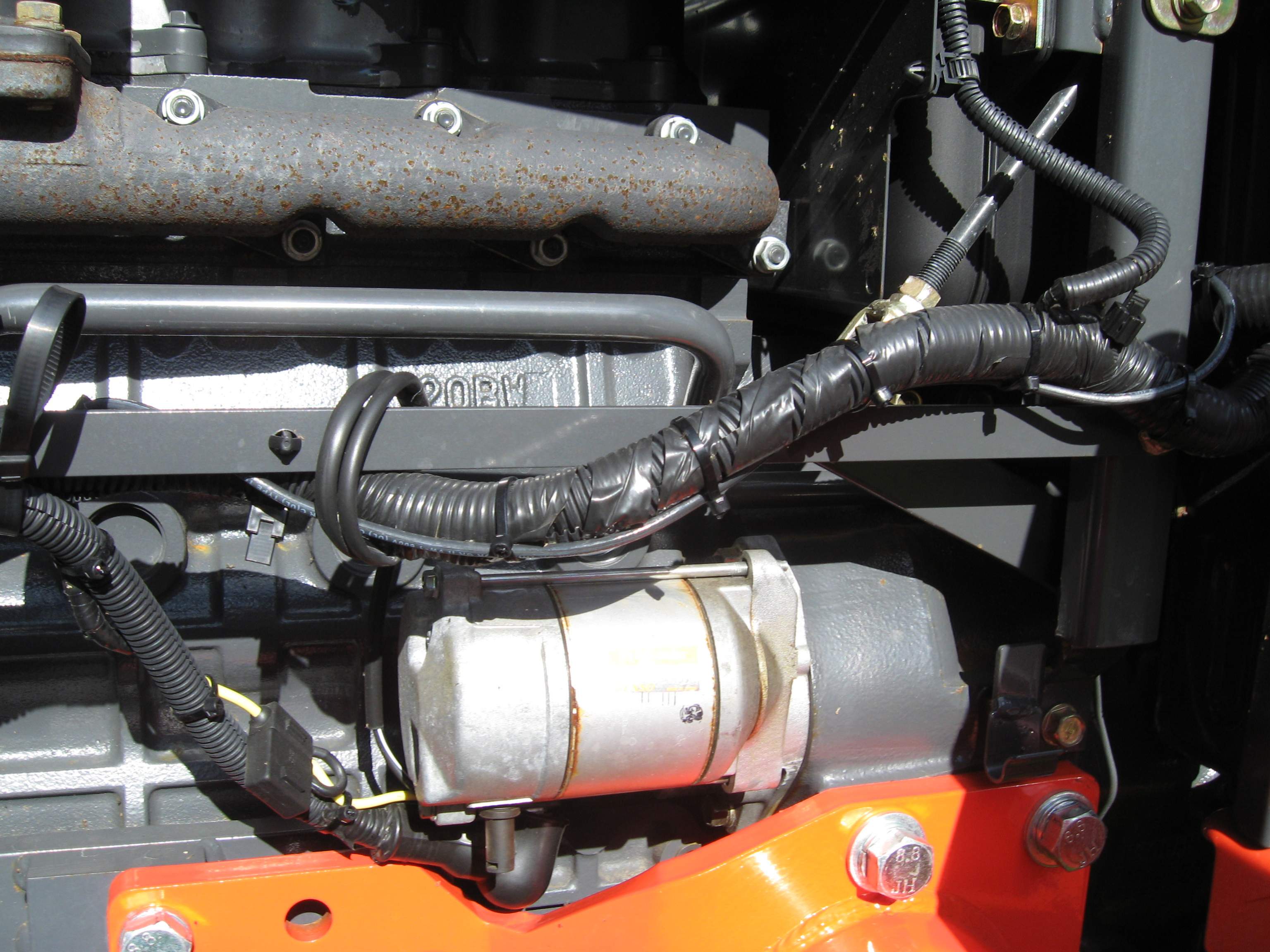

I hooked my lights up to starter lug that runs to battery with in-line fuse. Philip.

if you have a cetner reading ammeter that shows net charge.. don't wire to the battery as you will defeat the net charge / discharge scheme.
if no ammeter / charge lamp.. then it really don't matter.. source from a spot capable of handling the load, and fuse to protect the wireing and switch.
