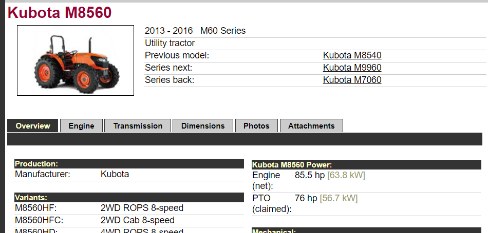

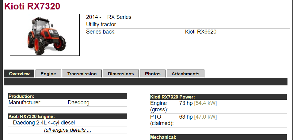

I'm curious how you think a Kioti RX7320 with 73 engine HP compares to a Kubota M8560 with 85.5 engine HP? I would think a Kubota M7060 would be a closer comparison to Kioti RX7320.
Indeed it would. I had been looking at a new RX7320 and a used cream puff M8560 was on the market for the same money. See the OP.
The newer 8560s use DEF (diesel exhaust fluid) and after having two trucks in the last five years that use it, I would stay with an under 75hp tractor that does not use it. DEF systems do not like sitting and need to be used often to keep the stuff stirred up. Went through three DEF system replacements on my Cummins Ram truck and about three months in the shop. If you need a 100+hp tractor that is not in daily production, get an older pre DEF machine.
