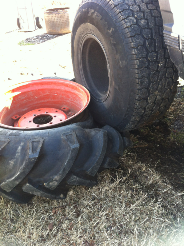

Tires Woke up to this today
   / Woke up to this today

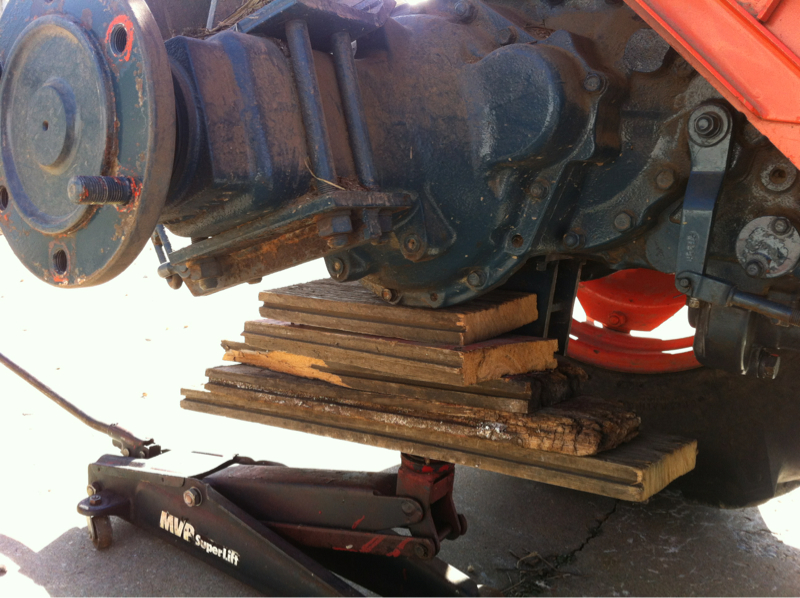

I've always wondered, why are there four bolts and two lug nuts? I can see why the studs help you locate the wheel, but why not use all studs and ditch the bolts?
I have no idea on this. Doesn't even seem like it would be a cost saver.
Anyone have any advise on getting the tube out of the tire? I have had good luck with tube patches in the past so I think I'll try that.
   / Woke up to this today #13
2 reasons for bolts instead of all studs.
1. cost - it costs more to make stud & nut for it than just a bolt. May not seam like much but multiply it by several thousand tractors built it adds up.
2. studs are on there for conveniecne of installation. - more so to reduce factory assembly time than for our (customer) convenience. In production, time is money.

That looks safe, right!
Ready to drive the truck onto tire to break bead.
#15
No suggested pressure on the tire. Any ideas? It's a 13.6-24.

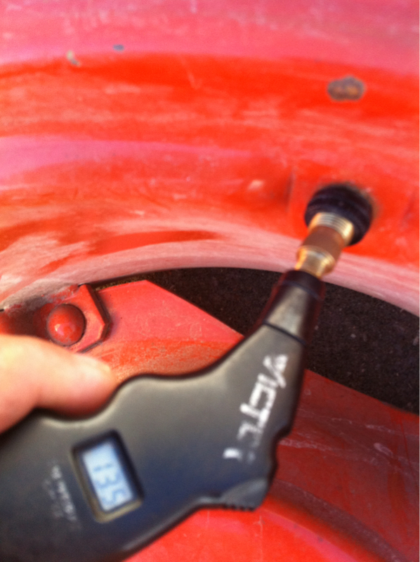

It's going down about .5 Lbs every 15 minutes. Time for a tube patch.

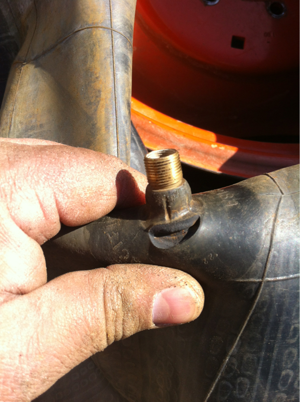

Tore the valve stem taking the tube out. Done for now until I get to Tractor Supply for a new one later.
