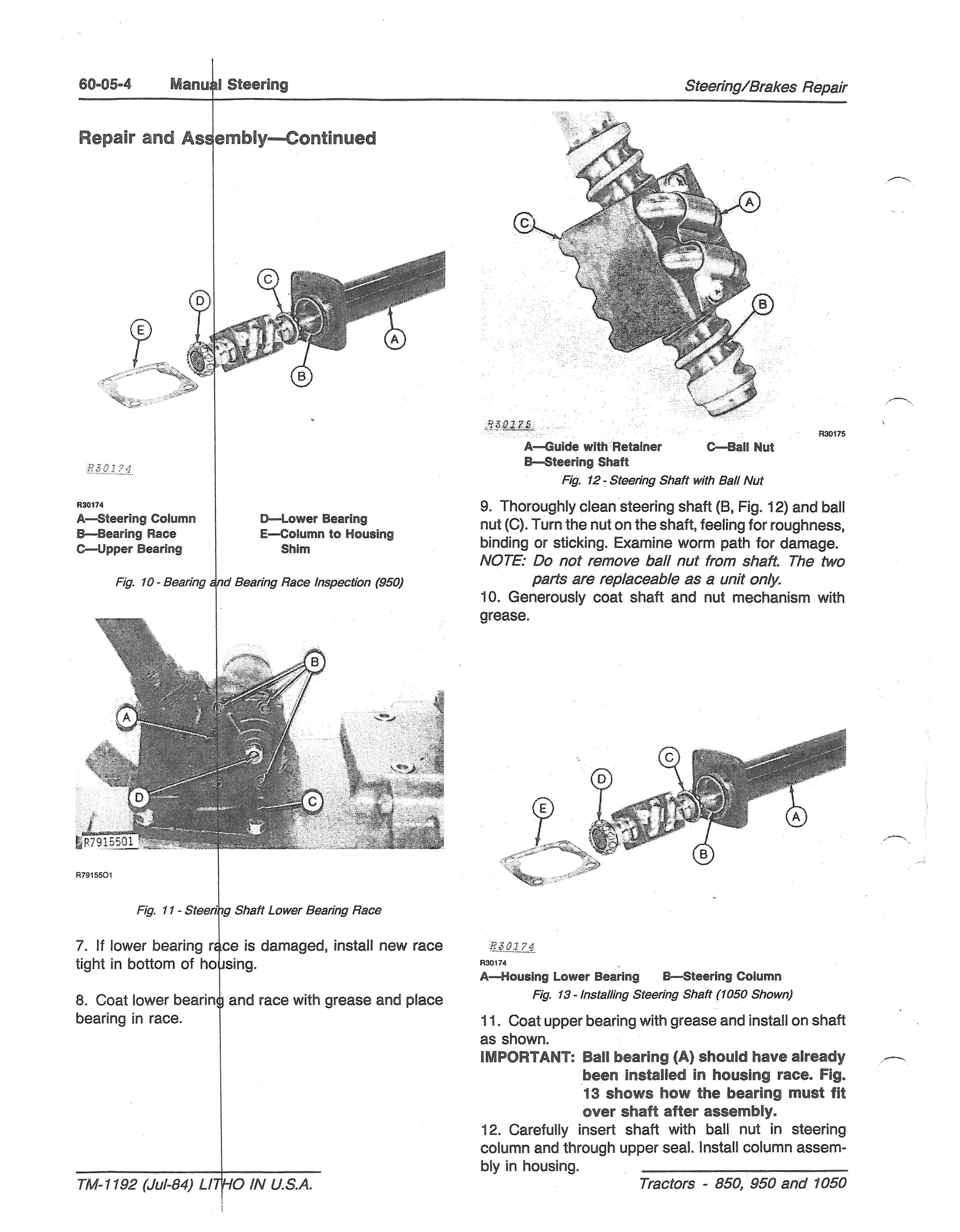

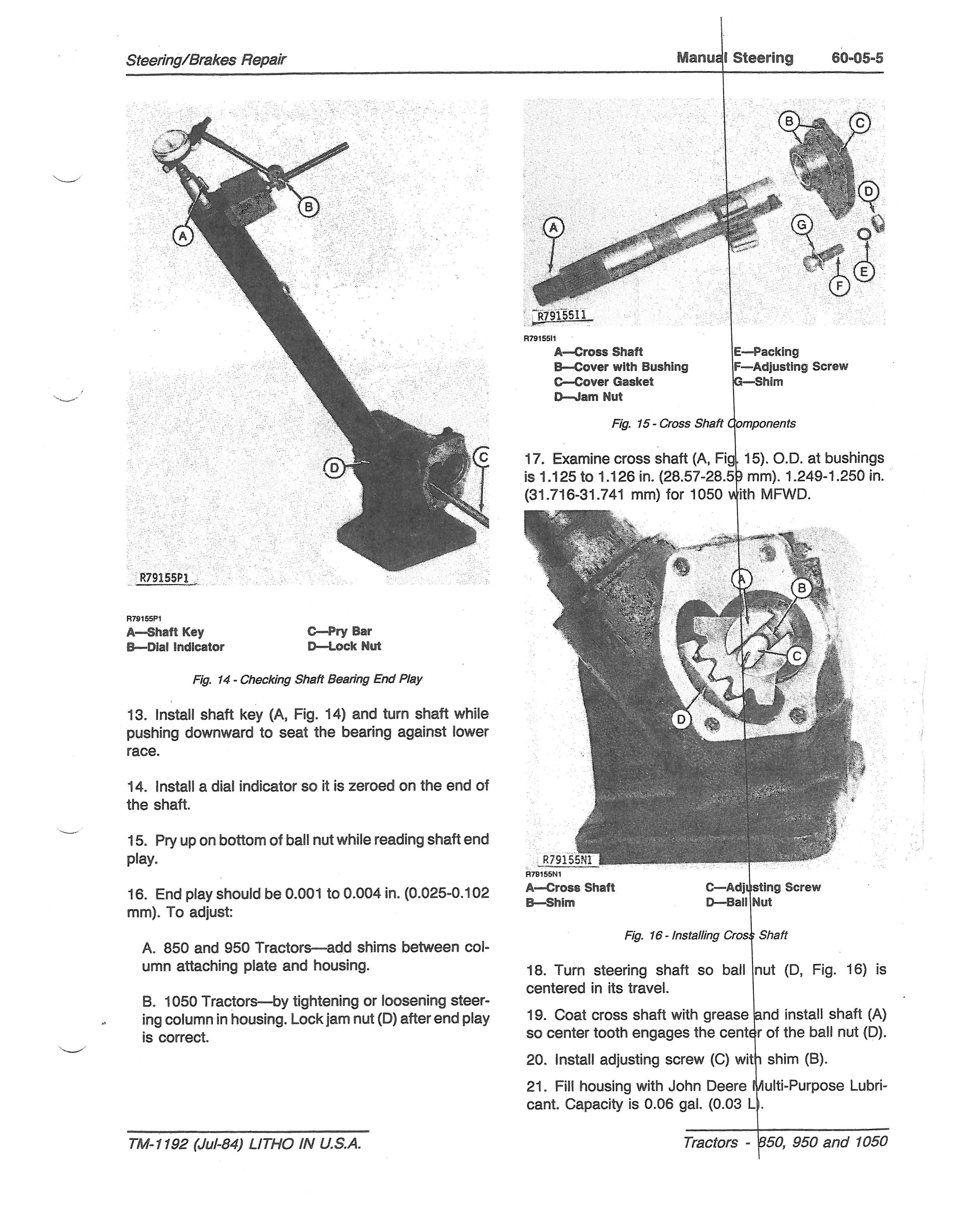

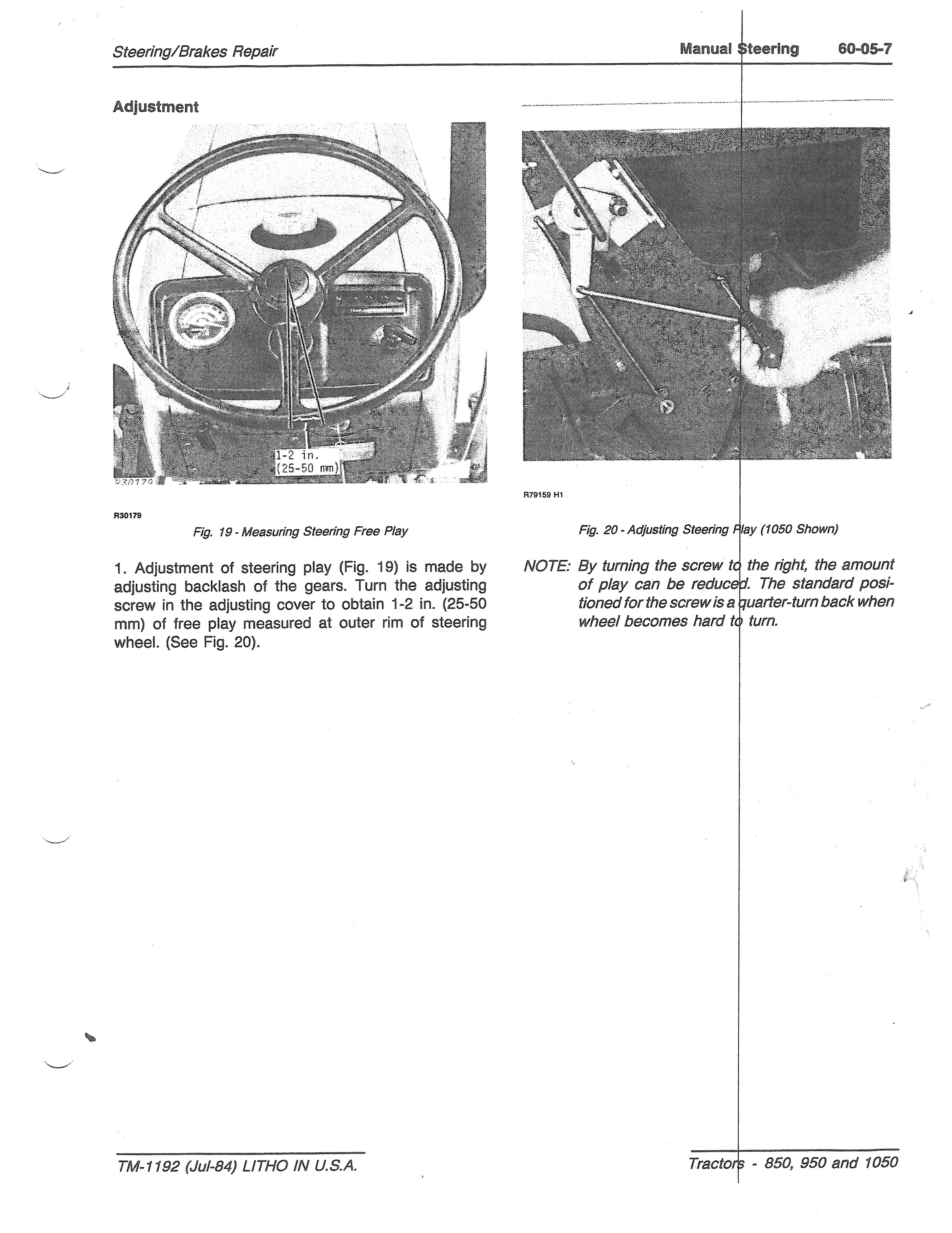

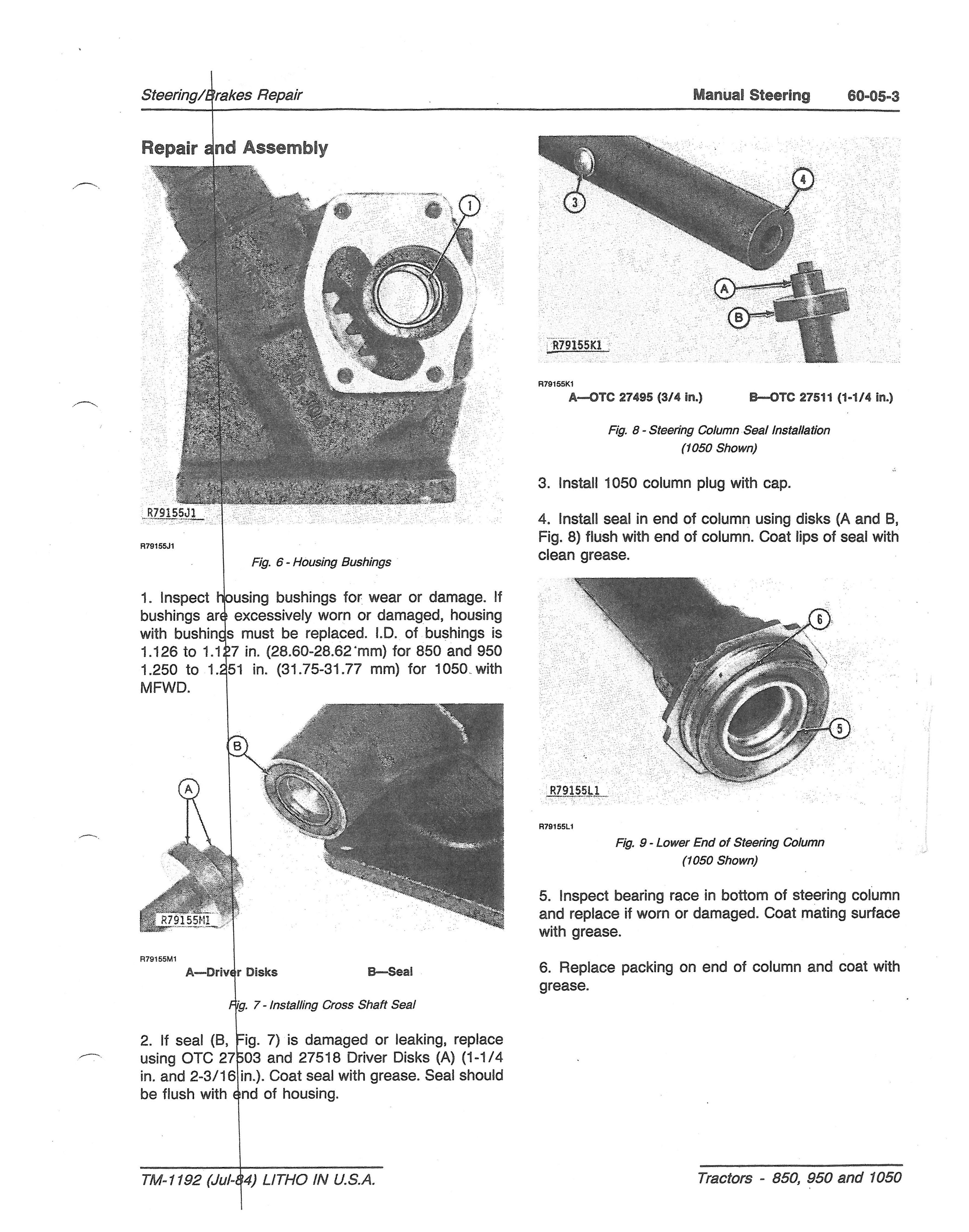

This is the info I have for a JD850,950,1050 and YM2500/YM2610 and it may be for other Yanmars about getting the steering tightened.
Sorry that the hi-res image sizes are a little large, but the scanner was not good for low-res files.
:2cents:
See the attached.
PS, the pages are numbered, but the uploading is random here. LOL

/ Wonky steering #11
This steering problem is called 'toggling'. Goggle some fixes. Tie rod may be too short which pulls in the inside wheel too much. I doubt the steering gear is at fault because its more of a geometry problem than a slop problem, unless the slop in the kingpin axes.
Look up Ackermann steering.
/ Wonky steering
#12
Those references where handy.
I think I can eliminate the steering gear as it seems fine.
I think the problem is a combination of slop at the steering kingpin, my non-stock tires (Car Tires) mounted wrong way around(fill valve on the inside) and perhaps I need a bit of toe in set at the tie rod.
I'll need to try my wheels to see if they can mount the proper way around. If not I may see if I can find some compact spare type wheels and see if they could fit better.
Then some toe in and take a look at the kingpin to see if its got an issue.
