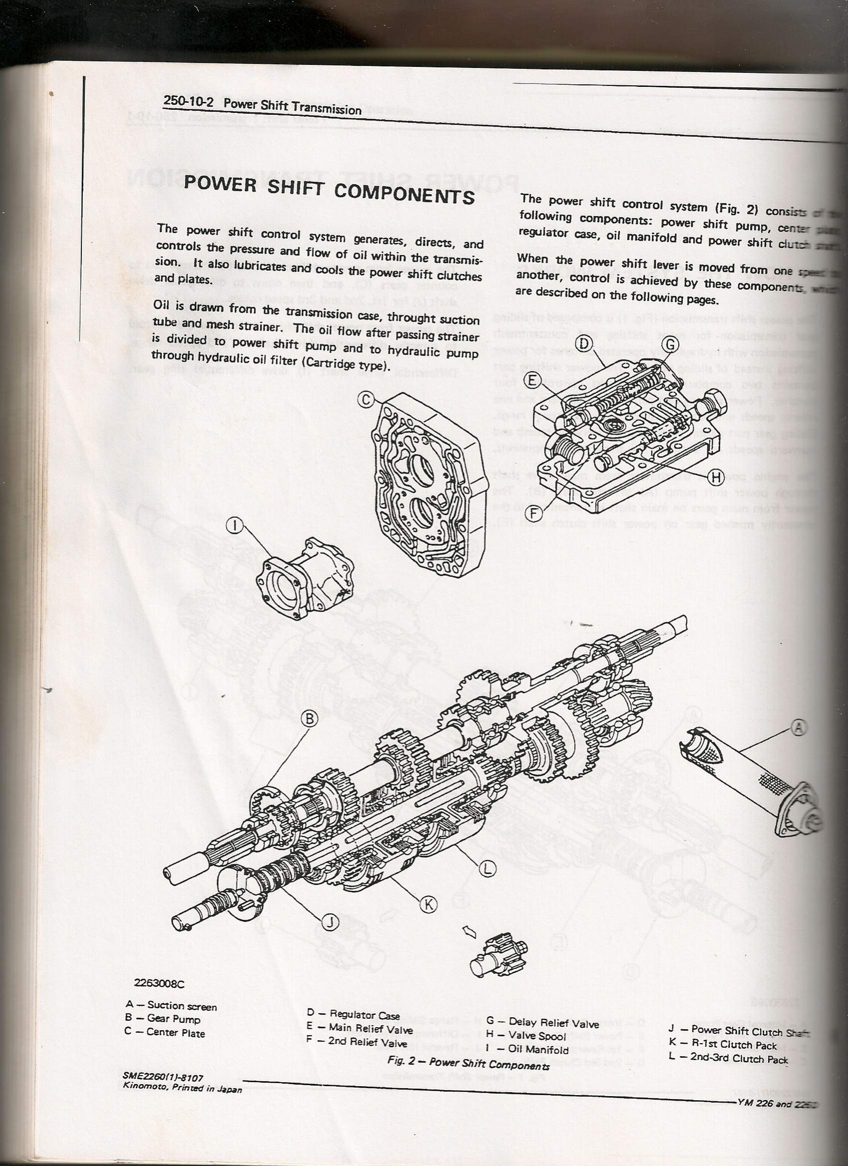

   / Won't go! #7
Here is a drawing of port locations and instructions on a YM226. Ref D on the drawing and you can see one plug on the back and one on the side. I have no idea whether your FX32 is the same or not. I would pay close attention to Aarons mention of the relief valve spring. You can see the ym226 relief valve in the same ref D. Only guessing the ST 1/8 threads mentioned might be British standard threads. Same as used on the oil pressure sending unit. Again, only guessing. Some have screwed in a 1/8" npt fitting at that point. Just one thread per inch difference. Should you be interested here is an adapter. http://www.hoyetractor.com/mm5/merc...re_Code=HTE&Product_Code=OGA-1&Category_Code= The more I look at the drawing it sure looks like a larger plug than 1/8?????

   / Won't go! #8
The FX32 Has a internal Power Shift Pump and so does the 226. If the Relief valve spring isn't Broken and the Valve isn't stuck or sticking. I would be looking hard at the Internal Pump. Blown seal,O-ring or Gasket Or the Dr. Shaft to the Pump.. I couldn't find any pics. Of the pump itself but there has to a way to check the pressure out of it to the valves or Valve Body.
Ah now that makes sence Typo! I believe 22- 4 power shift lever is the Internal Pump. I would start there and make sure it has pressure or the pump is working.
