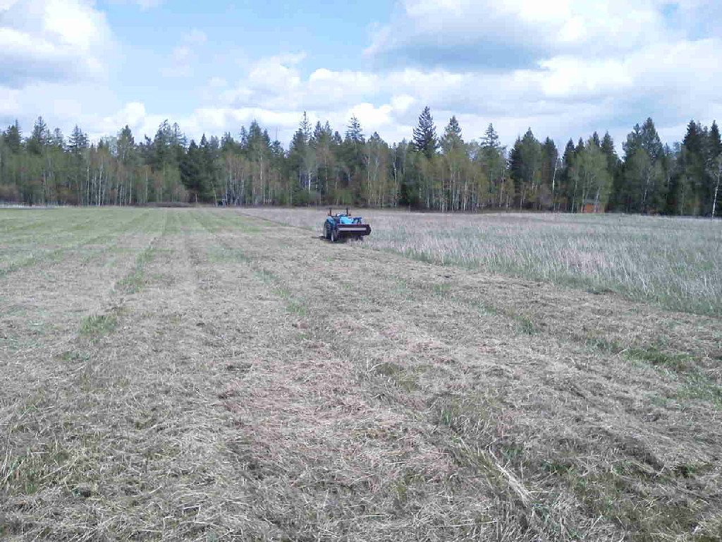

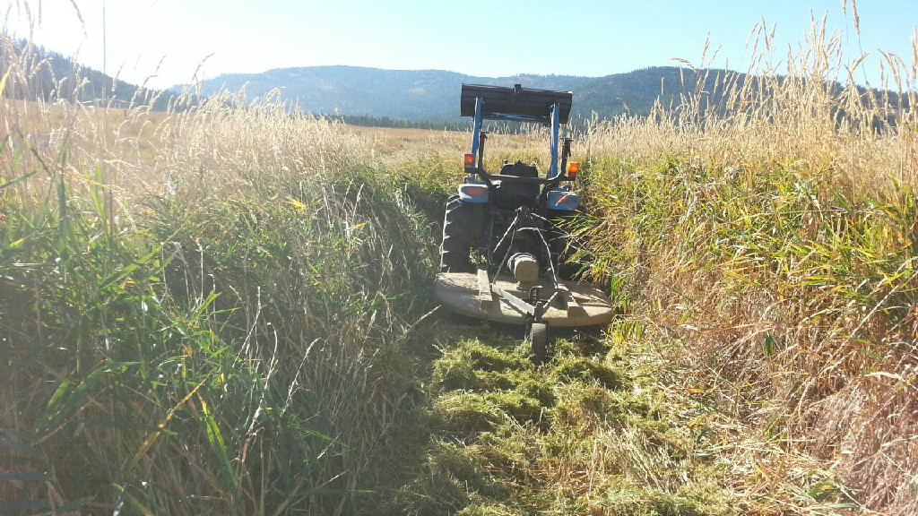

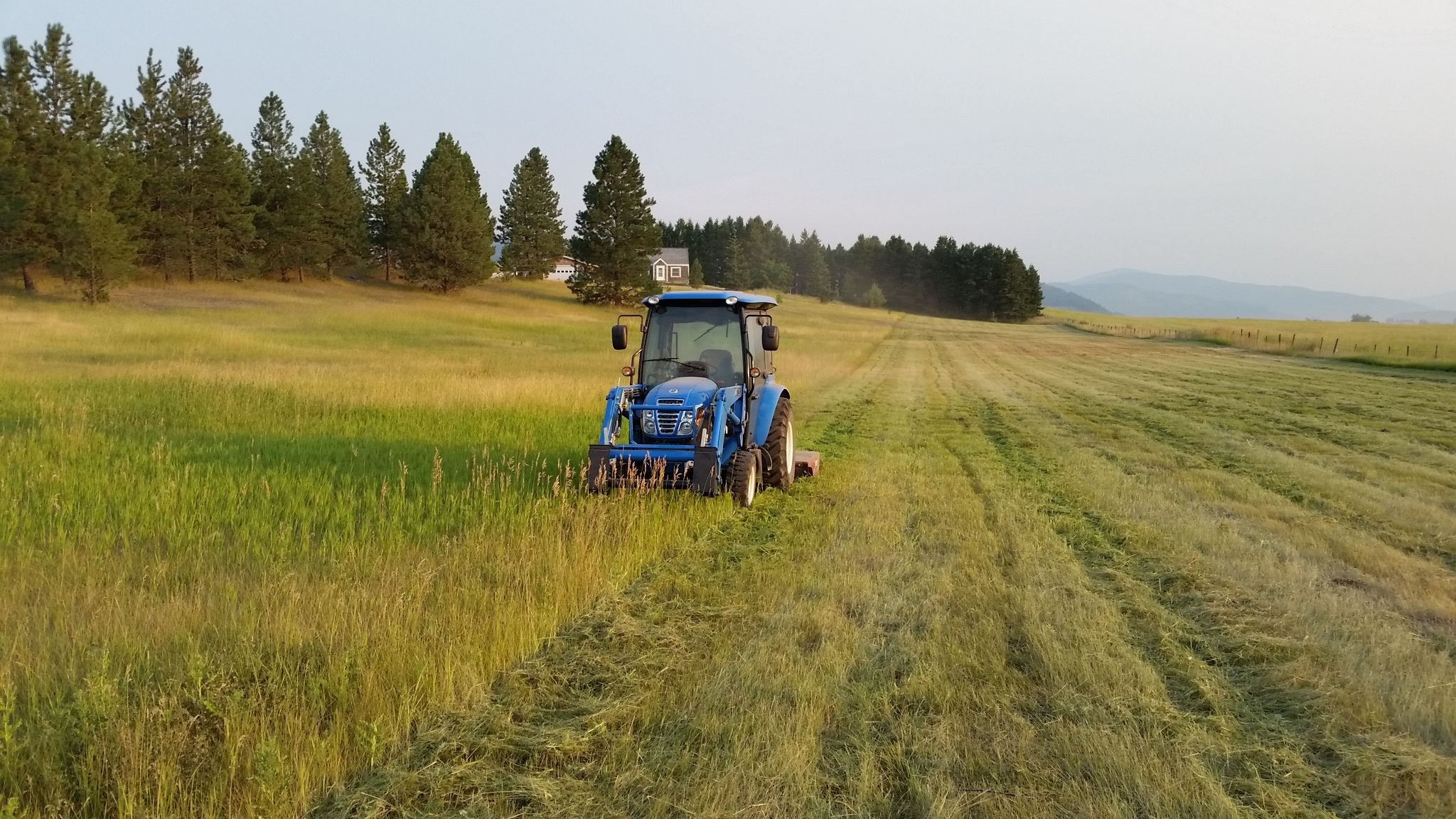

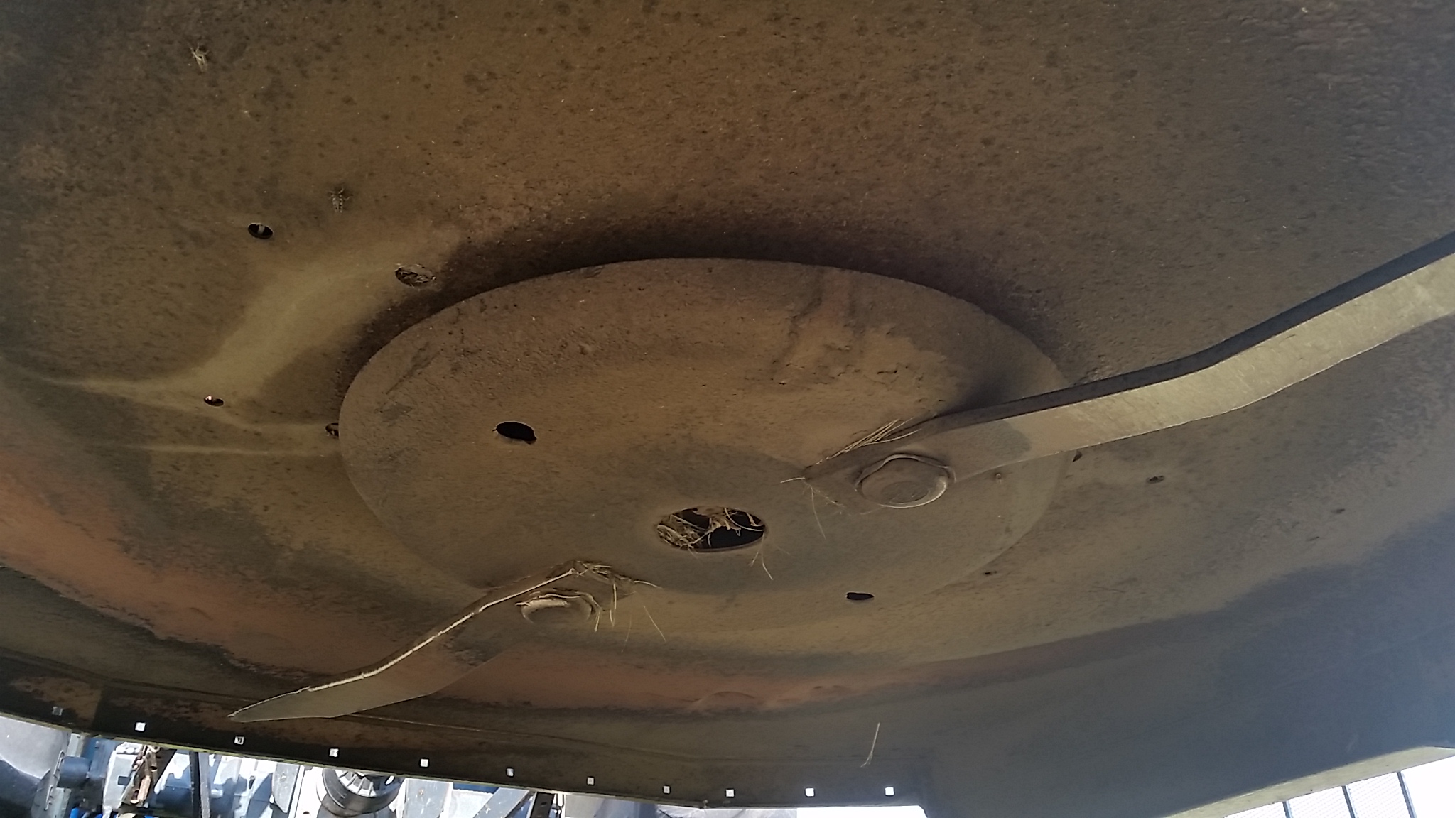

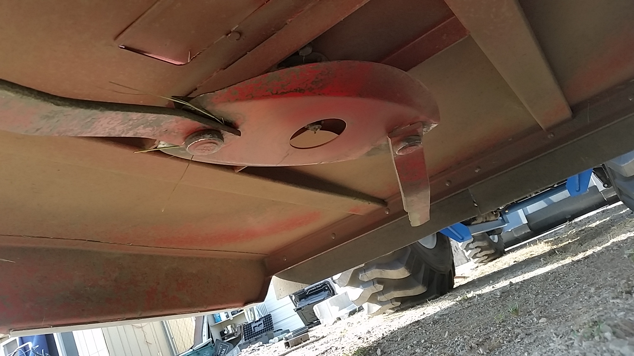

Running 3-4MPH at about 4". Gopher mounds are sometimes over a foot tall and in 6' tall grass like in the photo below, good luck seeing them. When cutting higher the dry grass does not shear off even with brand new blades. The cut looks like trash. If the grass is green it will cut fine at 8" but everything here is dead and dry by the end of July. If i try to cut at 8" i am down to 2MPH or less. Sharpened the blades and cut 6 acres last night. This was somewhat green so i cut at around 6-7" Very few rocks but VERY rough ground. Front of the mower was in the dirt many times if i wasn't fast enough on the 3 point. Right arm is sore from constant adjustment of 3 point. There was a few times with the mower all the way up where i was still in the dirt due to rough ground. As far as my lift it's 1,800 at the pins, NOT 6' behind the tractor. Factory says a 1,400# mower would cause me issues. Here are a few pics of some of our jobs. The cab tractor is last nights 6 acres. I also attached the bottom view of the LP stump jumper VS the Woods. Just seems like the LP is a WHOLE lot better built. I had ABSOLUTELY no complaints on the LP. I would still be using it today but it was about 8-10" to narrow to cover the tire tracks. Yeah it got a bit beat up but man did it cut nice! I guess i should have shipped a LP in at $600 freight and stuck with what serviced me well. Live and learn...............

And before someone says i should cut before the grass gets that tall, That property with the 6' tall grass cannot be accessed until August as it is too wet.............

I know which looks more robust to me and there is a major difference in design.
The thing that amazes me is that there is not baffle on either one of them:confused::confused:! I find that very odd. Maybe that is because they are both light duty and baffles only come on medium and above. I thought all quality rotary cutters had baffles.:confused2: I know mine does and am glad it does.

1 gauges may not seem like alot, but like I said, that in combination of spanning a smaller distance makes a huge difference.
Your woods cutter is basically 11ga band spanning a 6' length of side
The LP cutter is 10ga band spanning 5'
So kinda like a 2x4 spanning 10' or a 2x6 spanning 8'.
I do not buy into the whole low quality steel BS.
So the LP is 12% thicker, 18% smaller.. Should make it about 33% stronger.
--or--
The Woods is 11% thinner and 20% bigger. makes it about 29% weaker
