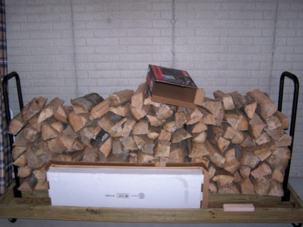

I've been burning non-stop for a couple of weeks and this furnace keeps things nice and warm, not to mention that the gas furnace has not run at all! We've kept a constant 71-72 degrees throughout our 2500+ sq ft home. Before on gas we only kept it at 68, how did we keep from freezing to death!?
Hopefully I have not driven anyone nuts with these posts but I did it with the intentions on showing anyone who was interested in such project. This site has been helpful to me and hopefully I can return that assistance to someone else.
Here's the best part....

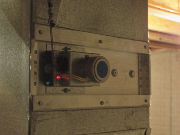

This is one of two (one is on the other furnace) of the low-voltage dampers that open and close depending on which furnace runs.

And lastly, here's a small rack that my step-son and I built to wheel over to the bottom of the steps when carrying in wood, it helps keep all of the debris off the floor.
   / Wood Burning Furnace, It's done...I'm Warm! #5
Re: Wood Burning Furnace, It\'s done...I\'m Warm!
Nothing like being warm and not breaking the bank doing it. Nice looking job, wood rack and all.
   / Wood Burning Furnace, It's done...I'm Warm! #6
Great idea on the wood rack. That would work perfect for me too. Thanks for the idea.
Ford850,
Thanks for the comments. This originally started as the basic log rack kit from Home Depot. The kit is the steel tubes/brackets and you add your own 2 by 4's. I just made it wider and put a floor on it plus added some HD casters and it works great. I can hold aprox. a face cord on it although it gets hard to push around!

Can you tell me if the low voltage dampers are absolutely necessary or could you just connect to the warm air and cold air plenums without dampers? Is there enough resistance thru the other furnace, blower and filter to keep from circulating extra warm air in a short loop thru the other furnace and back to the unit that is 'on' instead of thru the rooms and then thru the return air. I recall seeing installations without the dampers that seemed to work OK. Did your installation instructions call for the dampers?
