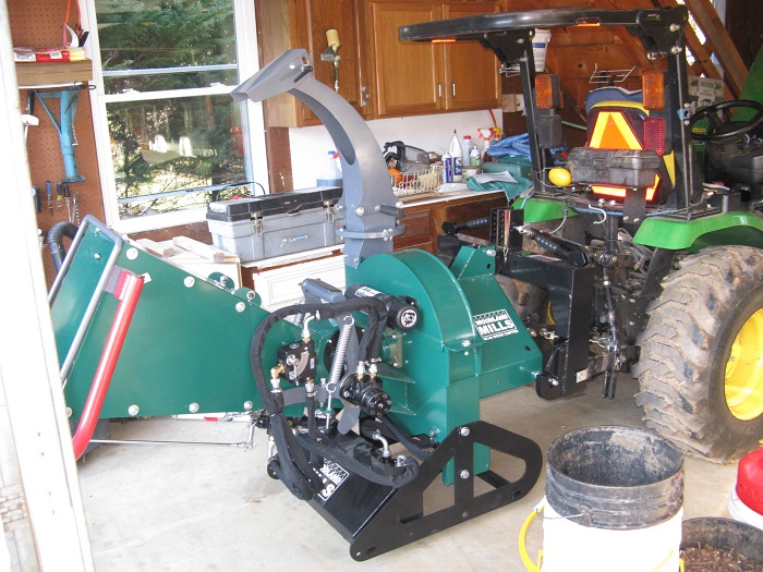

Just got a Woodland Mills WC46 (4 inch) wood chipper about a month and a half ago. Wanted one to make my life easier: horizontal input chute and hydraulic feed. The size of the chips would be set by the hydraulic feed rate and a little by the rpm of the tractor.
The WC46 makes a little bigger chips than the old MacKissic TPH-122 that I had for 16 years because I'm running it at about 2700 rpm (vs. 3000 for the "540") and mid speed on the hydraulic feed. The mid speed is comfortable for me, and the 2025R just loafs along at 2700 rpm.
Wanted one the wife could use, too. She can use this one. No to the Mac or any new Mac.
Fairly easy to assembly, but it took the 2 of us 3 1/2 hours to do it. Many men say 2 hours by themselves. They gotta be gorillas with 4 arms.

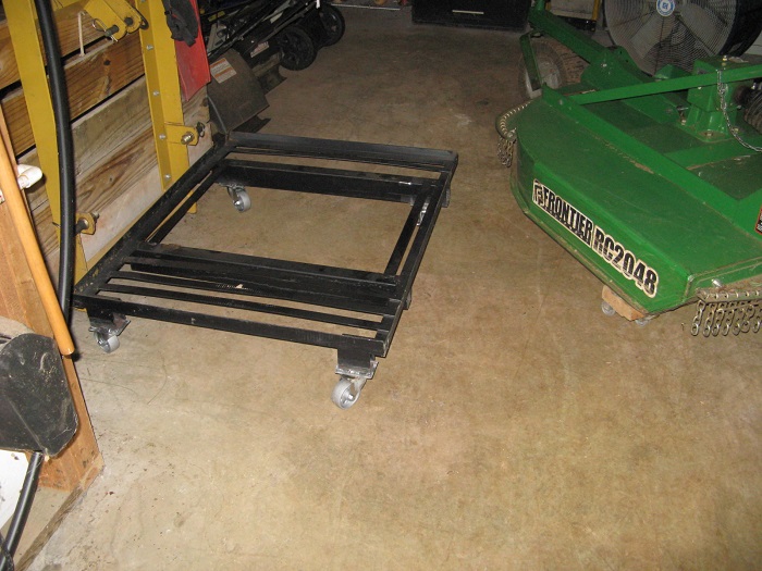

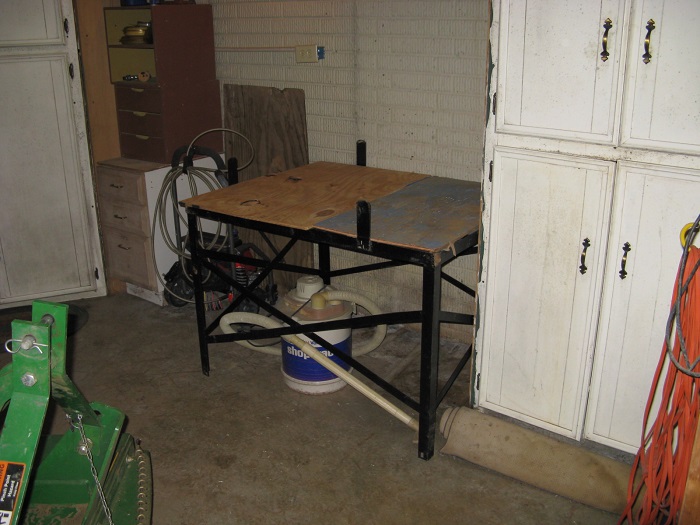

Made the shipping bottom into a dolly with 4 casters welded on and top into a table.

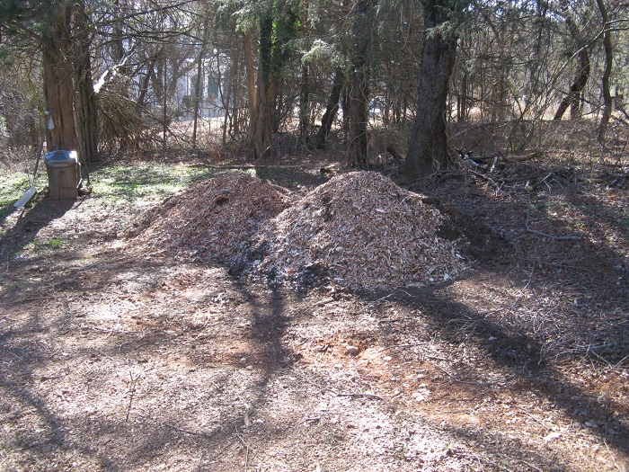

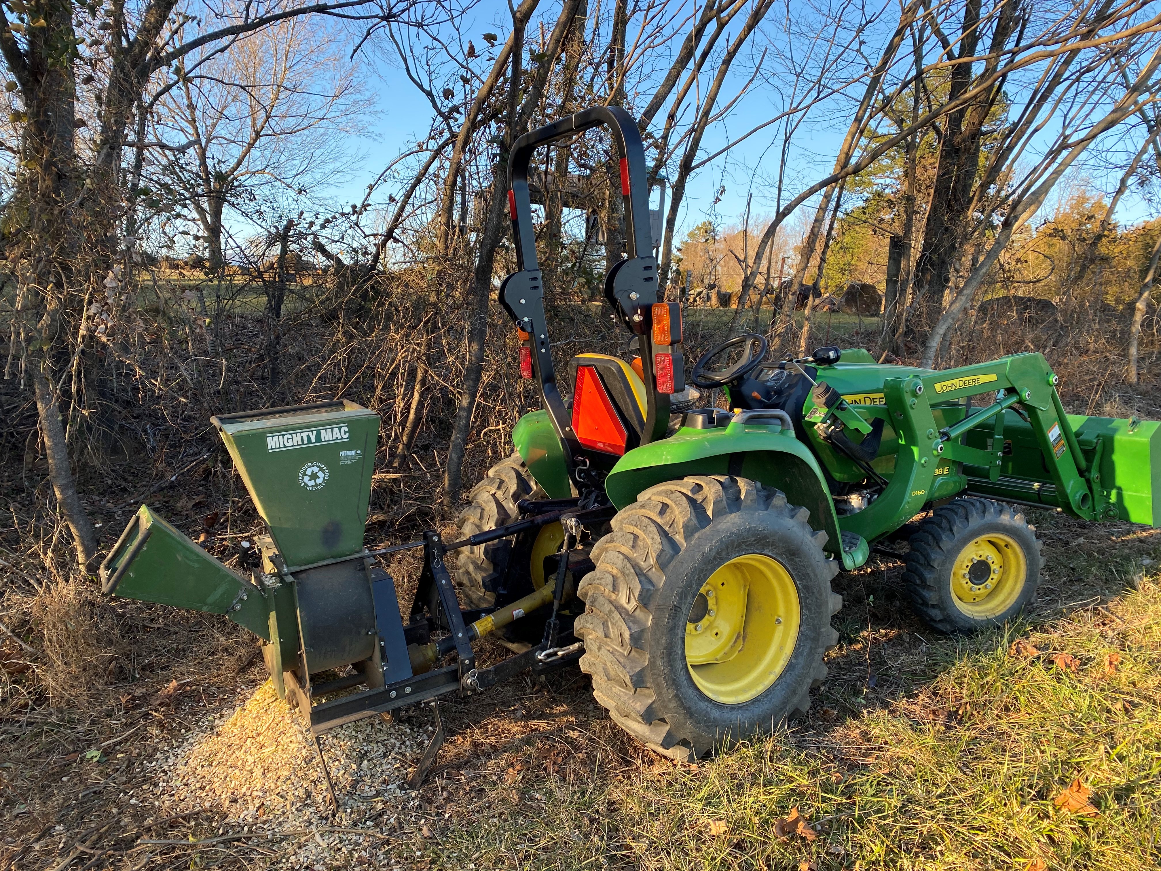

One pic is of the old Mac on its new owner's 3 series JD. The two piles just had an FEL of the new chips dumped onto them.
