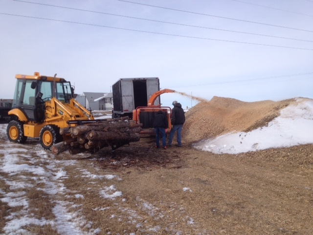

I also do quite a bit of chipping with a 12" vermeer. I often feed 10" logs through it and it takes a while but it gets the job done. It's certainly not ideal for lots for really small bushy stuff.

My suggestion is to rent if you are going to dispose of a large amount of branches. That way you can use your tractor to load the chipper. It is very difficult with a tractor compared to a skid steer but it can be done. If you are planning to hand load then you might as well just buy a PTO model and go that route as since you are using the bigger stuff for firewood you will mainly be processing small material.
