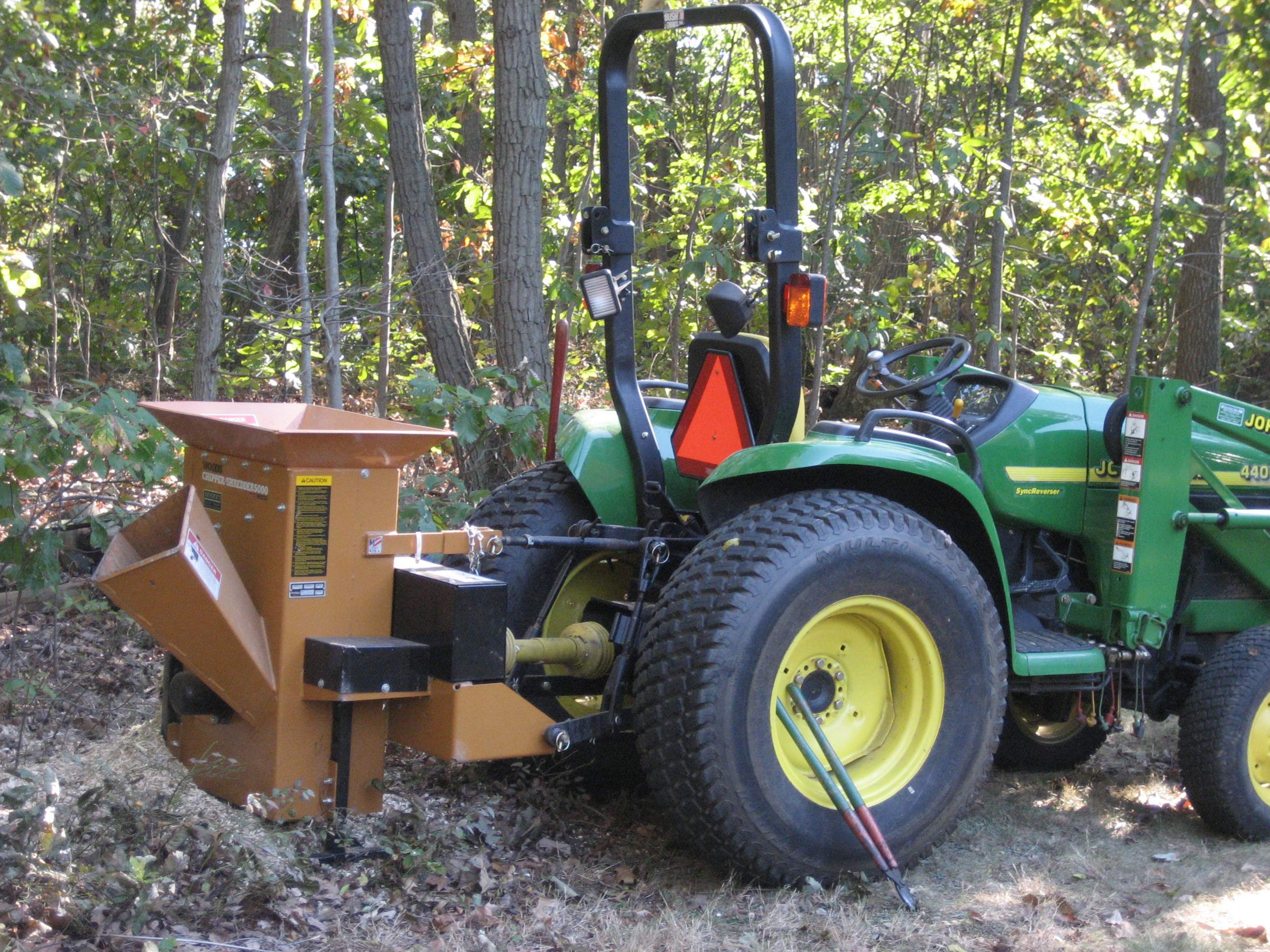

I've got a Woods (my particular model is made by Bearcat, sold by Woods). Great chipper!!
   / Wood Chipper #20
do you have trouble with it clogging? chute clogging?
This model, the 5000, doesn't have a chute. The chips fall below the chipper. There is a kit to add a blower/chute, but for the amount of chipping I do, I can rake out the chips (to a pile) and move them to another location with the loader.
Although the input chute looks awkward to use, it's not and it well suited for 5" material. I've fed smaller trees (5" trunk by 30-35 foot length) with no problems. The shredder (top opening) is good for material up to an inch in diameter as well as brush.
Freshly cut stuff chips OK, but I've found letting the material set for a few days to dry out results in easier chipping.
I bought this off CL for $1000. New cost as shown in the picture is a bit under $3000. For a homeowner with a few acres of trees or a small farm, the Woods (Bearcat) is a nice chipper. You'll want 20 PTO HP minimum to run it. Woods also puts a maximum of 30 PTO HP, but the Bearcat version (same machine) is rated to 40 HP.
BTW, if price was no object, I'd go for a Valby...but for my purposes, this Woods does a great job!!
