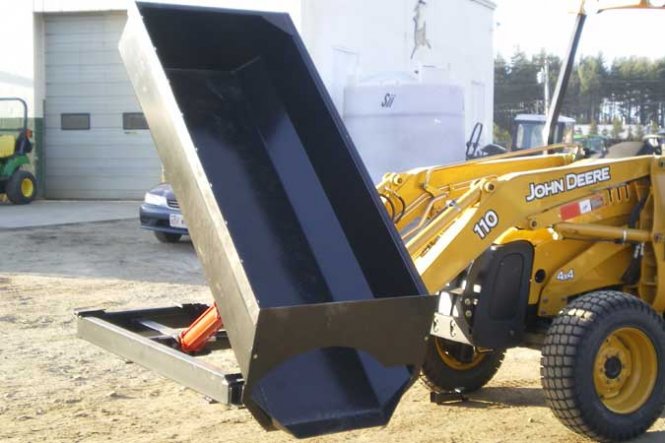

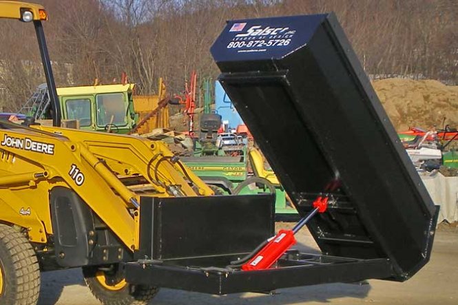

For those that need something similar, but bigger, the side dump bucket: https://duckduckgo.com/?q=side+dump+skid+steer+bucket&t=ffsb&iar=images&iax=images&ia=images
