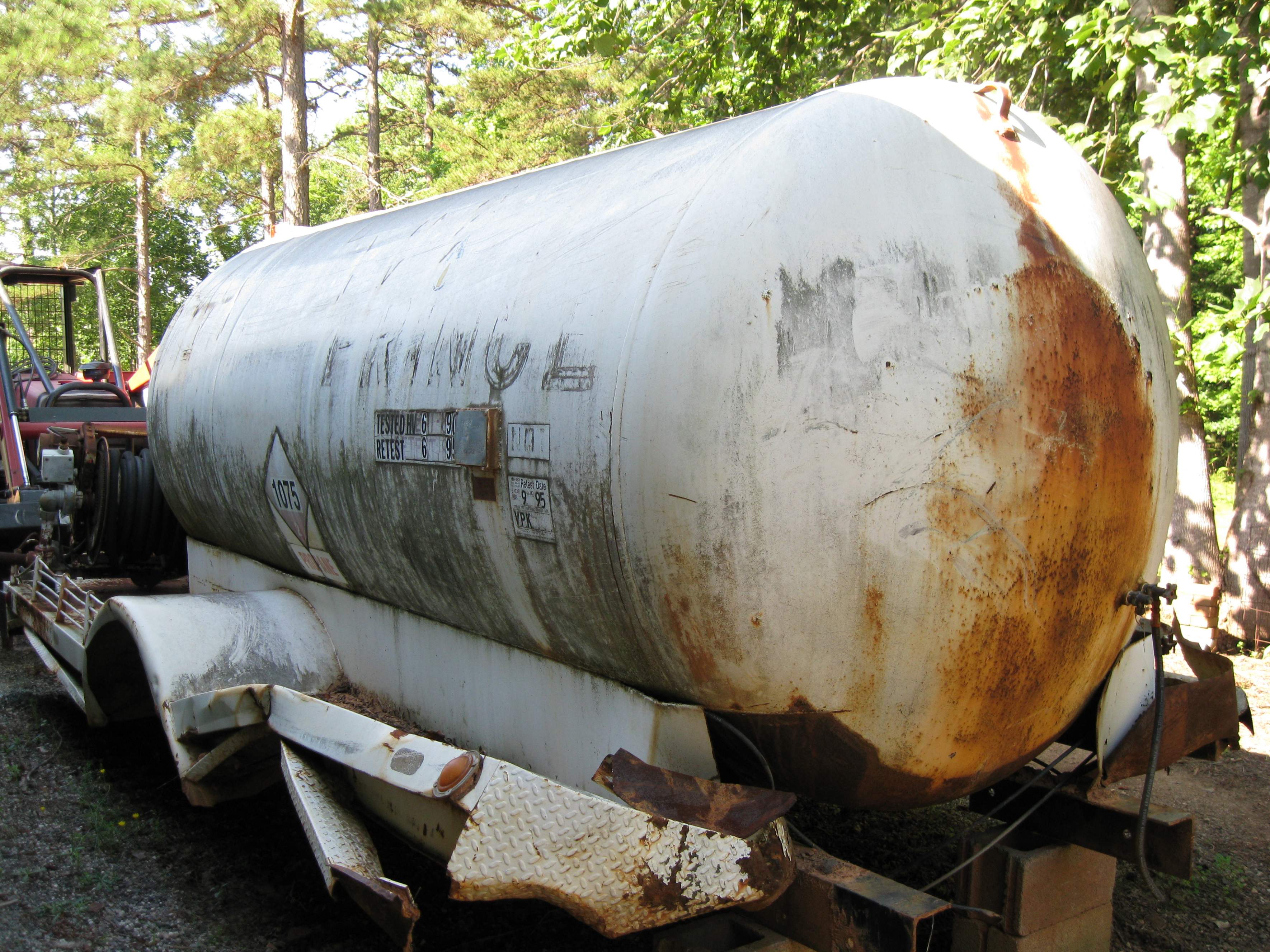

I have been trying to aquire all the items needed to build a indoor/outdoor stove. I don't know if I will ever get time to put the pieces together though. I could save a lot of money by building myself, but it would be a lot easier to just buy. I was even able to round up this 1800 gallon propane tank to use. I hate for it to go to waste.
