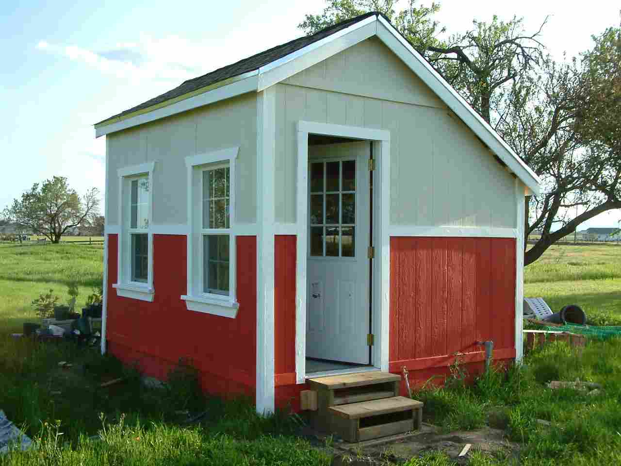

Sure, just paint the plywood floor with a good grade deck enamel. I built a storage shed for my garden tools, etc. a few months ago and used 2x6 floor joists on 12" centers and 3/4" plywood flooring. Used grey Behr deck/patio enamel from Home Depot. You can see a small part of the floor in the attachment.
