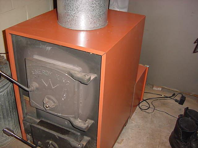

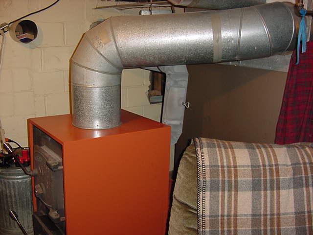

fenneran - A couple of pictures of how I've got my hot air from the wood furnce plummed into the plennum of my natural gas fired forced air furnace. Added benefit is the heat given off by the furnace into the basement - sit in my chair watching a Green Bay Packer game and usually doze off (hmm - I thought it was the warmth of the stove - just dawned on me maybe it was the game /forums/images/graemlins/smile.gif /forums/images/graemlins/smile.gif )

Pic #2

Penokee,
Get yourself one of them back draft dampers to prevent back flow when the gas furnace is running. Othewise you will get air flowing backwards into the wood burner. Unless the extra heat is not a problem. As far as sleeping during a Packer game that is normal. /forums/images/graemlins/grin.gif /forums/images/graemlins/grin.gif

Mine is in the basement connected directly to my masonry chimney. When Insurance company checked it out, their only requirement was that the wood stove pipe enter the chimney below the pipe from the natural gas furnace. Both connected to same flue. Codes today may require seperate flues.
