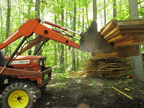

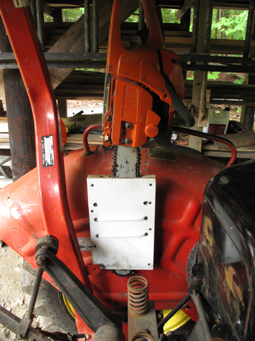

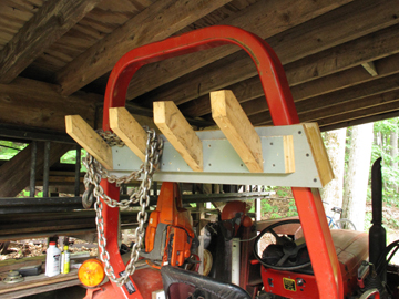

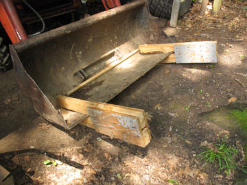

Here are some pics of wooden tractor modifications. Bucket forks, chainsaw and chain racks and a cant hook holder. So far everything is working as required. Scrap 2x4, 3/4" plywood, construction adhesive and drywall screws - cheap.

It's good to learn to utilize what you have on hand, that wood might not be your first choice but it gets the job done.

BRILLIANT! Creativity at its finest. May I copy some ideas?
As an aside is that saw a Husky? It looks like it. Ever have an issue with the gas leaking around the cap? All of sudden, second saw, and I am leaking gas.

LBrown59, really like the back hoe mod, :thumbsup: simple but effective.
   / wood (No weld) tractor mods #9
I am with you on the wood mods. Check out my post in the "attachments" section under "sun-shade". Wood has a much better strength/weight ratio than steel or even aluminum, which is good for keeping center of gravity down on top-mounted attachments, and ease of mounting. I also made some wood fork extensions, which I use quite often to lift the cap on and off my pickup with the loader. I aint a bad welder, and have made my share of steel attachments, but wood definitely has a place.
