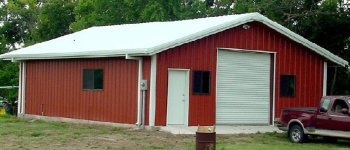

I built a Pioneer Steel building. 25 x 32 x 16

WVBill, thanks for the link to your barn raising. I had not seen that before and I enjoyed it. Nice looking barn you put up there.

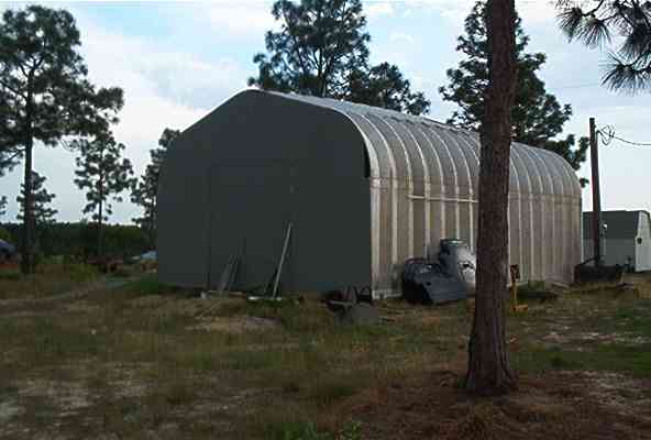

Prefab metal buildings are a good way to go. I put up a 30'x40'x10' building about 3 years ago. Had a contractor pour the slab. Had help putting up the main I beams and roof panels. Otherwise I did it all myself. It is fully insulated.
