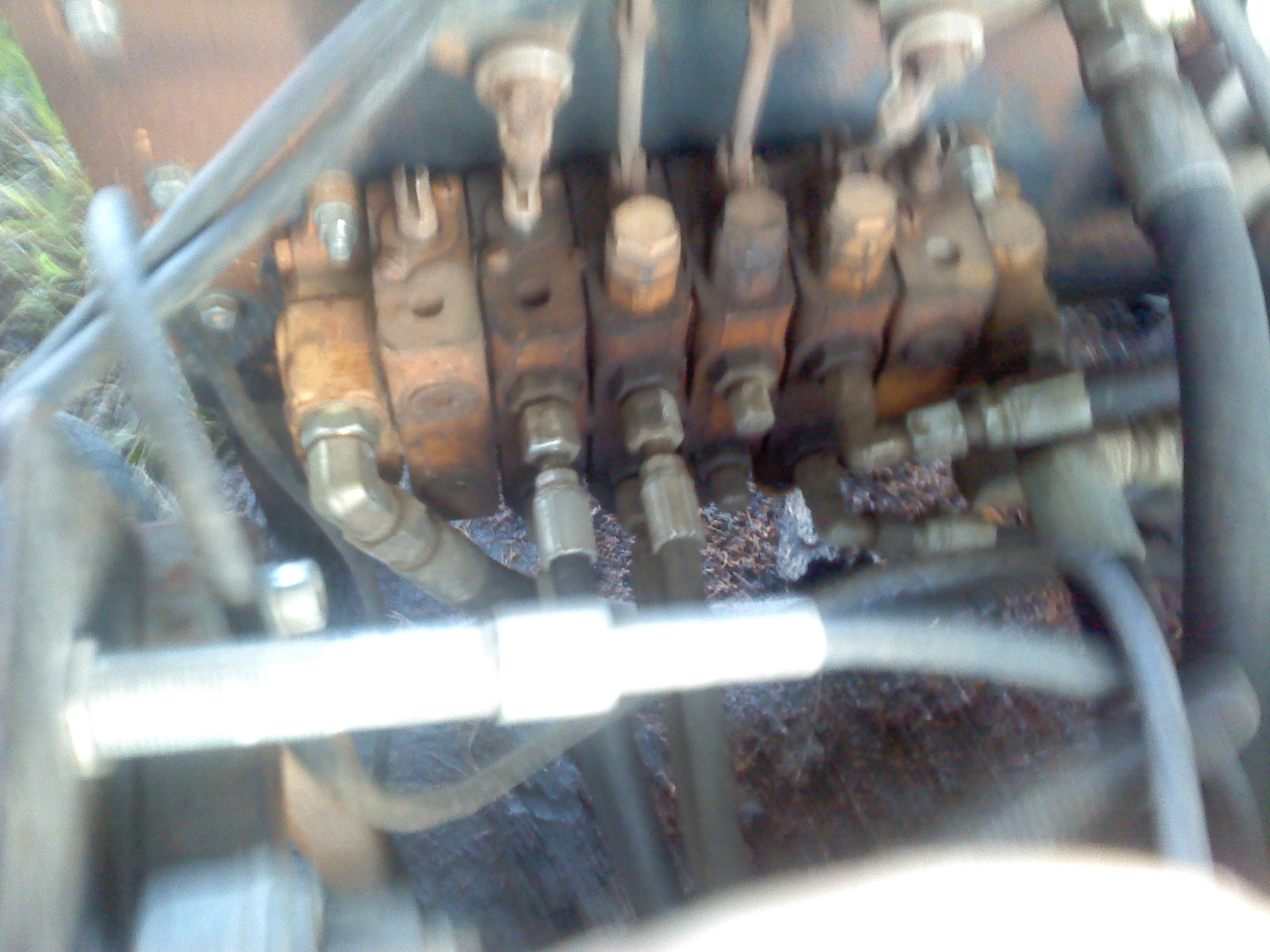

I have two different Husco stacked valve bodies. Both 5000 series, 5005a. One valve came off a ditchwitch and is currently on my wood splitter, it has 6 spools and I am only using one of those spools for the wedge lift. Long story but anyways. The other valve is a new 10 spool I salvaged from a scrap bin. Both valves have PB. The 10spool valve also has the center combiner valve section for adding more flow to the valve, Not sure how its supposed to work, but I dont need it so it will be taken out of the circuit. 1103151623.jpg. The 6 spool valve has a main relief and three spools have additional reliefs. 1103151702.jpg. What I want to do is take one section out of the 10spool valve and add it to the 6 spool valve. I also want to remove the combiner section completely and reduce the number of spools to just 5. If i can find a couple of endcaps for a 5000series husco valve, I would be able to put together another set of 4 spools stacked valve. The reason for wanting to make put together the 4spool valve set is so I can put that valve back on my splitter. I need the seven spool set to operate my home made knuckle boom and the other 5 valve set is to operate some of the functions on my processor. Yea, i could just put the 10 spool valve on the knuckle boom and use the 6spool on the processor and have exra valves for each bu then I would have to find another valve with pb to put on my splitter. So if anybody has a set of endcaps for a 5000series husco valve set. Let me know
