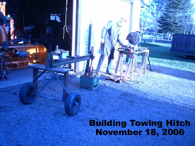

Vallyfarm gives good advice about trying out and being comfortable with the table height before you buy. I have been using a Poulan with the beam only 12" off the ground since 1979. It has always worked great but it is a real back killer. One of my projects this winter is to rebuild it: raise it to more comfortable height, add infeed and outfeed tables, replace the worn-out engine, and maybe, just maybe, build a hydraulic lift to get the big sticks up off the ground.
