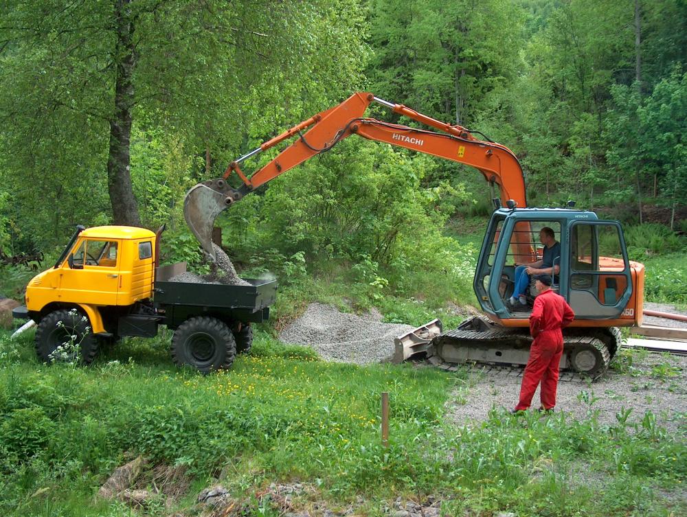

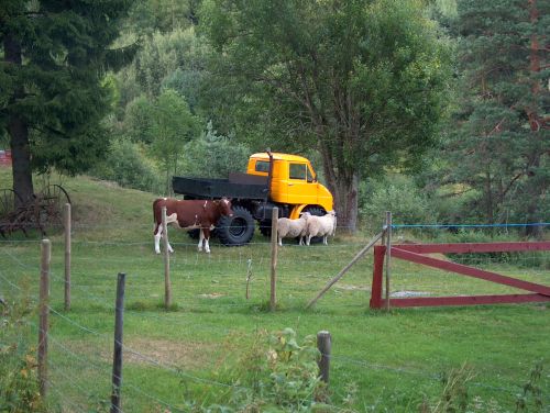

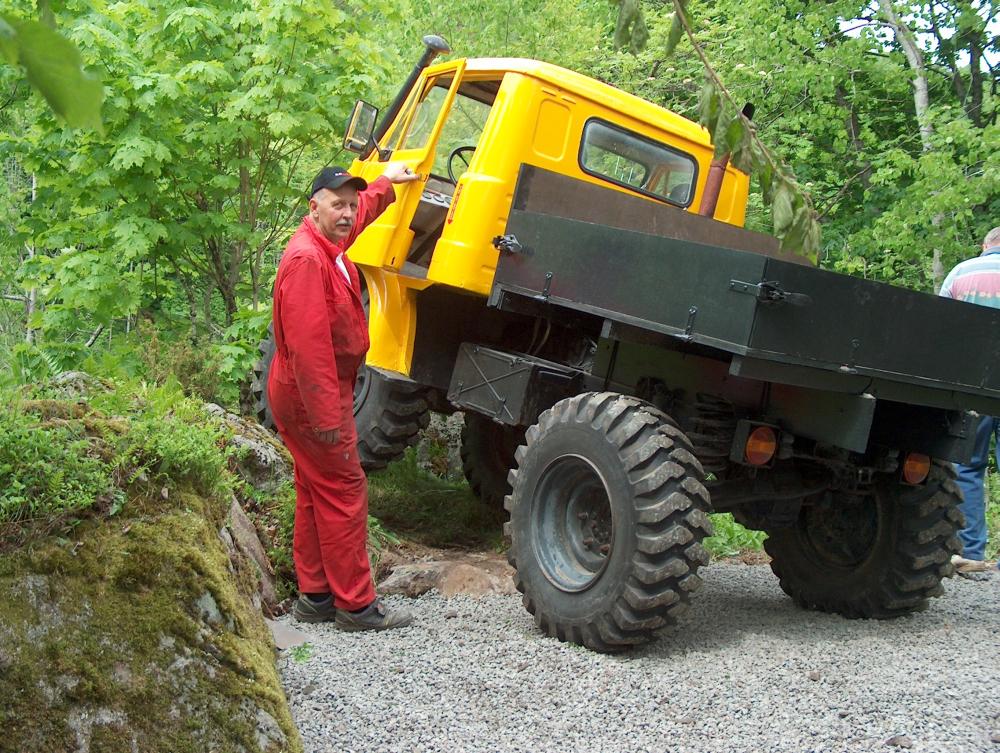

I love the Unimog!! Is it gas or diesel? They are pretty rare here in the states
It is a 1,8 liter diesel, 40 hp

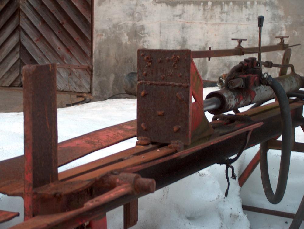

If you are going to make a splitter yourself, remember to make the ram high enough, so that you can split two smaller logs on top of each other in one stroke. Same thing with a bigger log that you give one split, returning it, turning the split log a half turn, (held together as one) and splitting both parts in one stroke.
