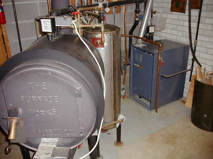

I've a wood burning stove heating water that feeds into the house hot water heat system. When the power goes out, I operate the damper manually, and unscrew the back-flow valves so gravity can move the hot water through the system. Takes some 'hands on' but the place stays warm without electricity.
Attached is my indoor boiler. Not sure where these type and size can be purchased, as I was told that nowadays they need to be steam certified if put in the house. So, the move to put them outside. This pic shows the wood 'boiler', with a pre-heat tank for pre-warming 30 gal. of water before going to the domestic hot water heater, and shows the plumbing in the background with the gas back-up boiler. These can be operated separately or in series (not very efficient).
I am a firm believer that undersize is better than oversize, for several reasons. Efficiency is one, burning hot is another, and heating a large mass of steel and/or water takes longer than you want to wait for heat (and keeps giving off heat long after you have had enough /forums/images/graemlins/tongue.gif ).

That picture makes a point and begs the question of- do you want a frankenstein in your basement or the fine piece of furniture that a woodstove can make?
I think many on this site will appreciate the frankenstein approach for its utility. Maybe there's room for both.
